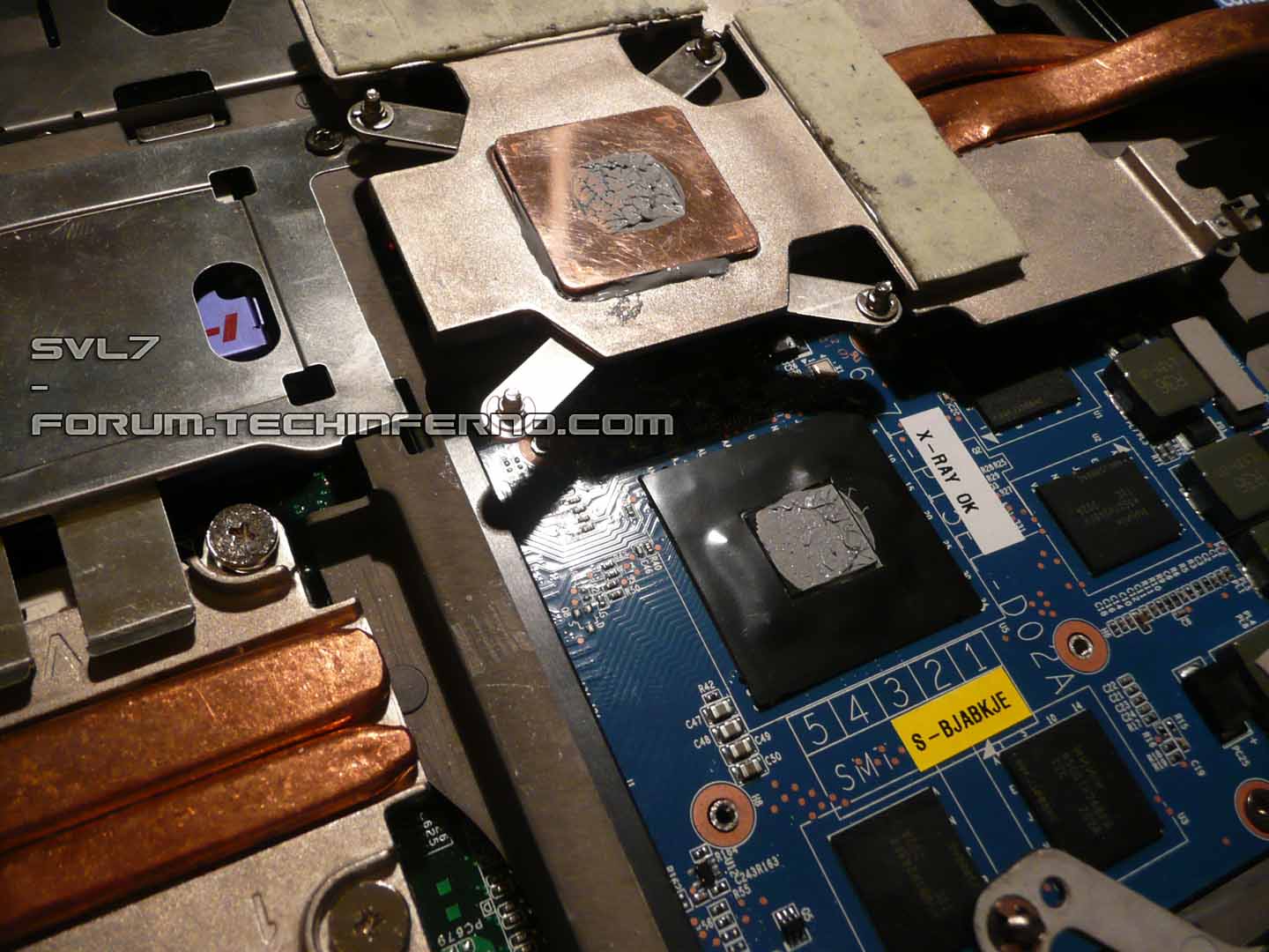

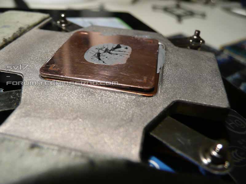

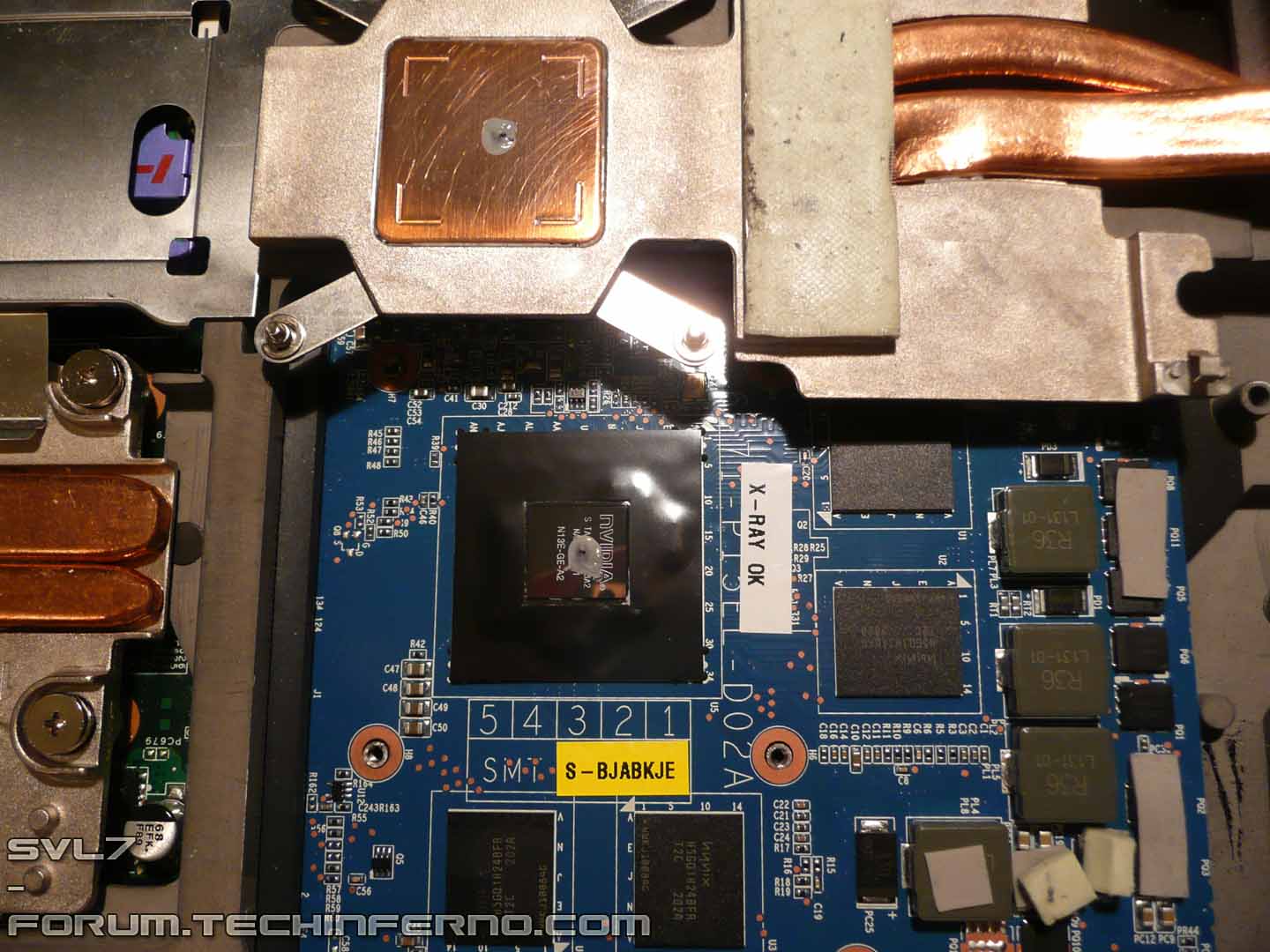

svl7 5640 Posted September 29, 2012 Alienware M15x & Nvidia GTX 660m ('Kepler' card)Here's what you need for this mod:Nvidia GTX 660m (I only tested the Clevo card so far, you can grab it from mxm-upgrade, already pre-flashed with the proper vbios).copper shim of about 1.0 - 1.5mm thickness.thermal paste (and some rubbing alcohol or similar).the attached vbios and .inf file (in case your card doesn't already come with it pre-flashed). the latest BIOS (A09). *highly recommended* -> ESD mat and wristbandThe upgrading procedure:Make sure you're familiar with the steps, take your time for the whole procedure, no need to hurry.Remove the AC adapter and battery of your system, perform a power drain (press and hold down the power button for about 15 seconds).Remove your current video card. All required steps for doing this are documented in this guide, grab it here..Once you removed the video card, clean the old thermal paste on the heatsink, rubbing alcohol or similar will work fine..The 660m which I used has some of the coils placed at a weird location (actually not MXM conform). This will lead to serious issues because the heatpipes of the M15x heatsink are getting in the way, resulting in a very bad contact between GPU die and heatsink, see the following picture:The picture shows the spread of the thermal paste after mounting and then removing the heatsink again. It's clearly visible that the paste didn't spread at all, there's no contact between die and heatsink, which is really bad.In order to solve this issue you need to put a copper shim between die and heatsink. I recommend putting the shim on the heatsink, use a little thermal paste and press it on, so you get a 'sandwich' consisting of the copper shim, a bit of thermal paste and then the heatsink.Once you've done this, put some thermal paste on the GPU and then mount the heatsink as usual. The result can be seen in the following pics, it's obvious that the pressure between heatsink and die is now very good:.Re-assemble your system and power it on. In case you got the card pre-flashed with the proper vbios it should boot fine. Else you probably won't get any picture on the internal monitor, but should be able to see something per DisplayPort. In that case you'll need to flash the vbios which I attached to this post. (to be updated with more instructions).Install the drivers, you'll need to use the modified .inf file, which can be found at the end of this post as well..That's it. The card works perfectly fine, including DisplayPort and audio per HDMI/DP. I haven't been able to overclock the card per software though, only per vbios mod... but the result is quite impressive :NOTE:I only tested this with the Clevo 660m, I can't tell you how it'd work out with the Dell card, and I can't recommend flashing the Dell card with this vbios, it might not work.Let me know if you have any questions!EDIT: Modified vbios attached, for overclocking fun Clevo_660m_M15x.zip660m_M15x_modified_inf.zip660m (Clevo) GHz Edition.zip 4 Quote Share this post Link to post Share on other sites

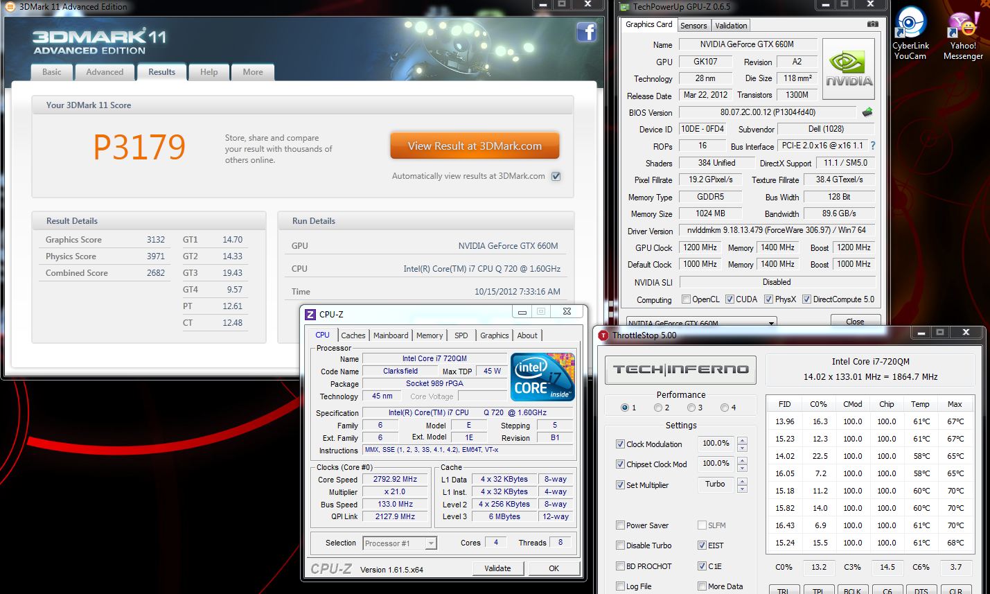

warren_briones 11 Posted October 15, 2012 what do you think of these scores:driver crashes if i set it to 1300Mhz any tips? i am really thinking of getting the 940xm... 1 Quote Share this post Link to post Share on other sites

svl7 5640 Posted October 15, 2012 what do you think of these scores:[ATTACH=CONFIG]5153[/ATTACH]driver crashes if i set it to 1300Mhz any tips? i am really thinking of getting the 940xm...More voltage might help, but the score looks great. The 940XM might help a bit in certain games, but don't expect huge gains.Finally!I found out, that doing things in the right order sometimes helps ;-)After flashing the vBios in the first post in this thread a clean install of the NVidia-Drivers was needed - and suddenly everything (including Display Port and laptop display) work fine.Cool, nice to see it working! Quote Share this post Link to post Share on other sites
