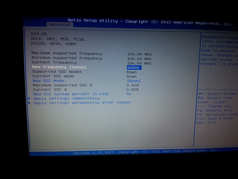

Morning All, thought i would give this a go this morning and unfortunately cannot get past the first step -
Anybody have any ideas what I can do - im on a medion x6823 (copy of ms-16f3)
[ATTACH]10785[/ATTACH]
My bios is here, it has been unlocked and I was thinking that maybe now I have all the advanced options in the bios that I may have a setting to set the flash descriptor overide (gonna make a vid of my bios and upload to YT) -

The bits are already set for bclk overclocking.
Instead of 10000 just write something like 10100.
But you should try first playing with bclk in Intel XTU, it looks safer to me.
Don't know how your computer/bIOS will react to failed overclocking, but if it doesn't reset the settings you will be caught in a POST loop and you will have to take out the CMOS battery I guess.
So, play it safe first...
I cannot change bclk, look in prevois photo at max bclk it is set to 100 and min is 100.. Any idea why this is ?
Oh, I got it.
In that case you need a modified ME just like the one Khenglish built for me.
