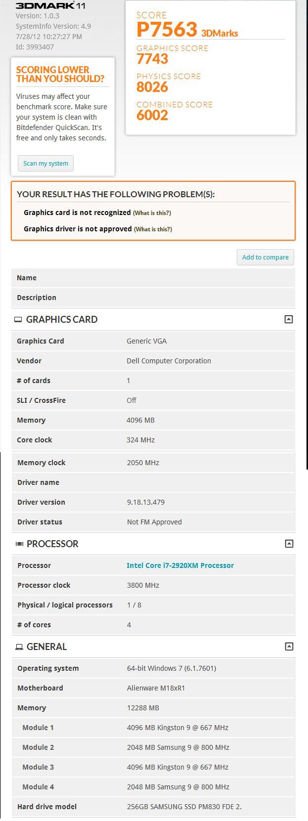

Teaser pic for you guys, this is 3dmark 11 with the GPU OC'd on STOCK voltage (this already bests my 580M SLi OC'd score):

Latest (and final for now) score is higher :) That one will be in the review that will be going up later this week.
