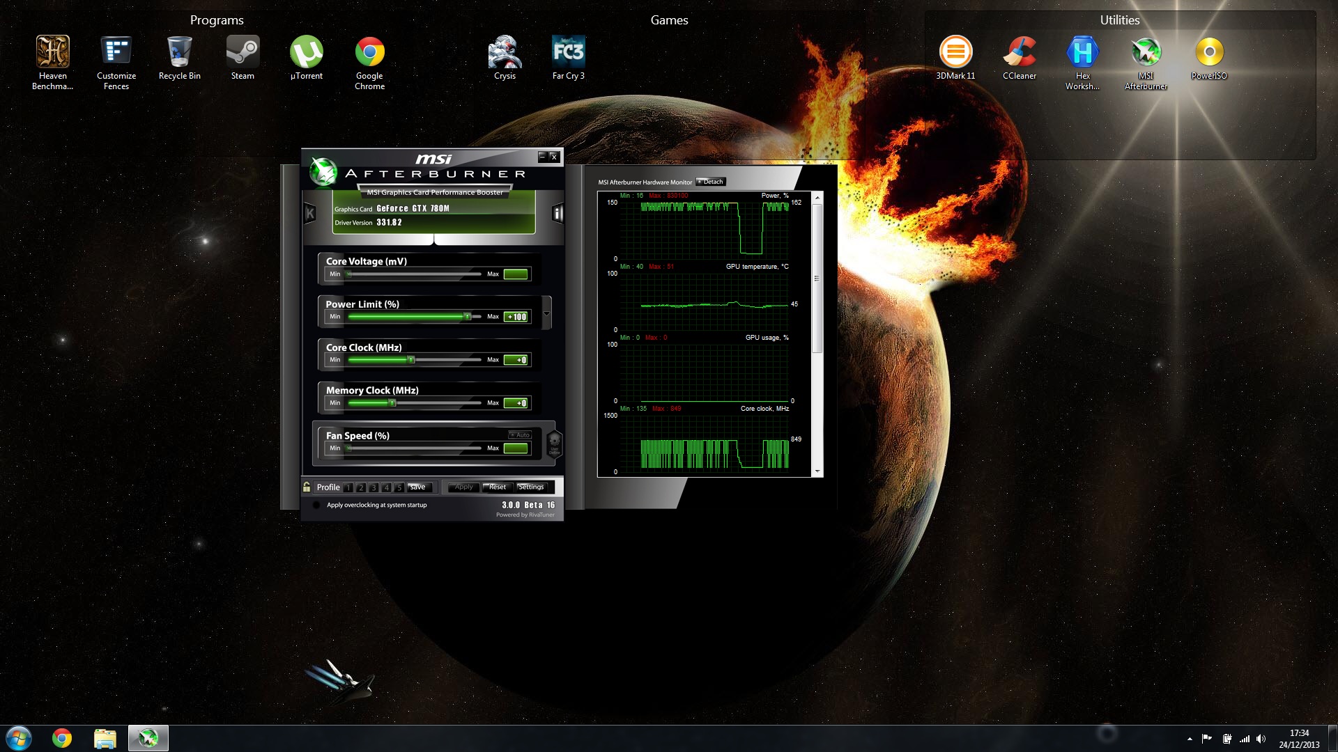

Also can anyone confirm if it's normal for msi afterburner to see my GPU fluctuating from 849mhz to 135mhz every second on idle. I get a squiggly line graph. and then it levels out after a while. It does the same thing with Nvidia inspector . THanks
That's odd. Do you have a second monitor attached?

Hey guys is this normal? The big dip is when I opened up google chrome, and then closed it and it kept doing it :/ It's really weird, everything fluctuates at the same time.

Hey guys is this normal? The big dip is when I opened up google chrome' date=' and then closed it and it kept doing it :/ It's really weird, everything fluctuates at the same time.

As to your clock fluctuations, I'm not sure it's important really?! What does it affect? Doesn't seem to have any ultimate consequence if I look at it superficially?

Thanks for replying Robbo, turns out im stupid and those readings were from my MSI pinging my GPU. So probably normal.
