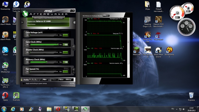

Somebody have the same problem?[ATTACH=CONFIG]5001[/ATTACH]
I cant really see your pic good but it seems your clocks are changing several times a second or close to that. That is strange. Is unofficial overclocking enabled in Afterburner..ini file? Im not sure if that has anything to do with it but for AMD and afterburner the .ini can tell powerplay to be disabled and lock 3dclocks. Maybe you need to do similar. I dont know if this is a boost issue or not. what vbios did you use?
I'm using the sl7's vbios mod. I noticed that this clocks changing only when temperature reaches the level of 93-94. And i tried to do something with Afterburner cfg file, no effect.
The issue seems to be a normal temperature based throttle.. If its only at 93-94c then i wouldn't worry as you shouldn't game at that level temperature or bench for that matter. Can you improve your temps any? Maybe an aftermarket paste or up the fan speed?
