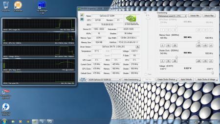

Here some pics, at 810MHz and further overclocked per software... yeah, this works very well :)

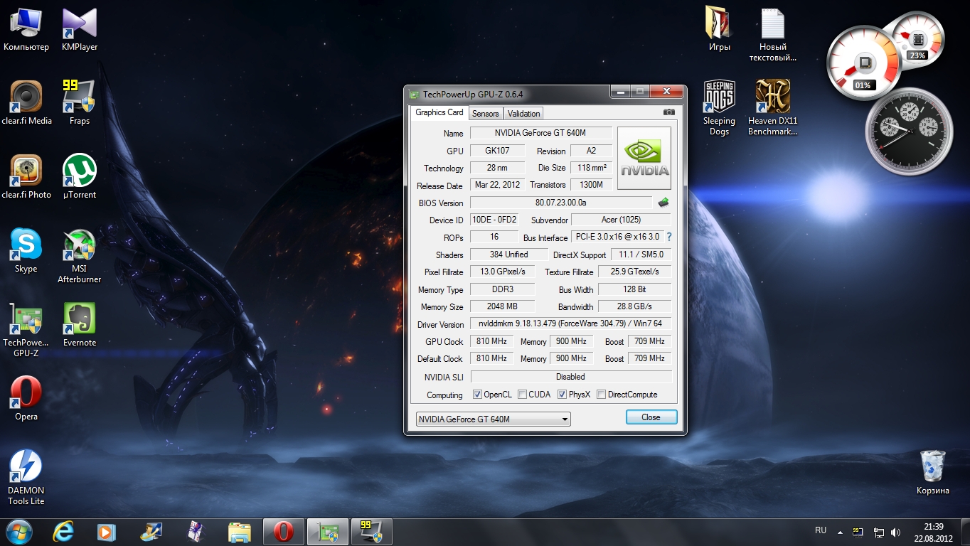

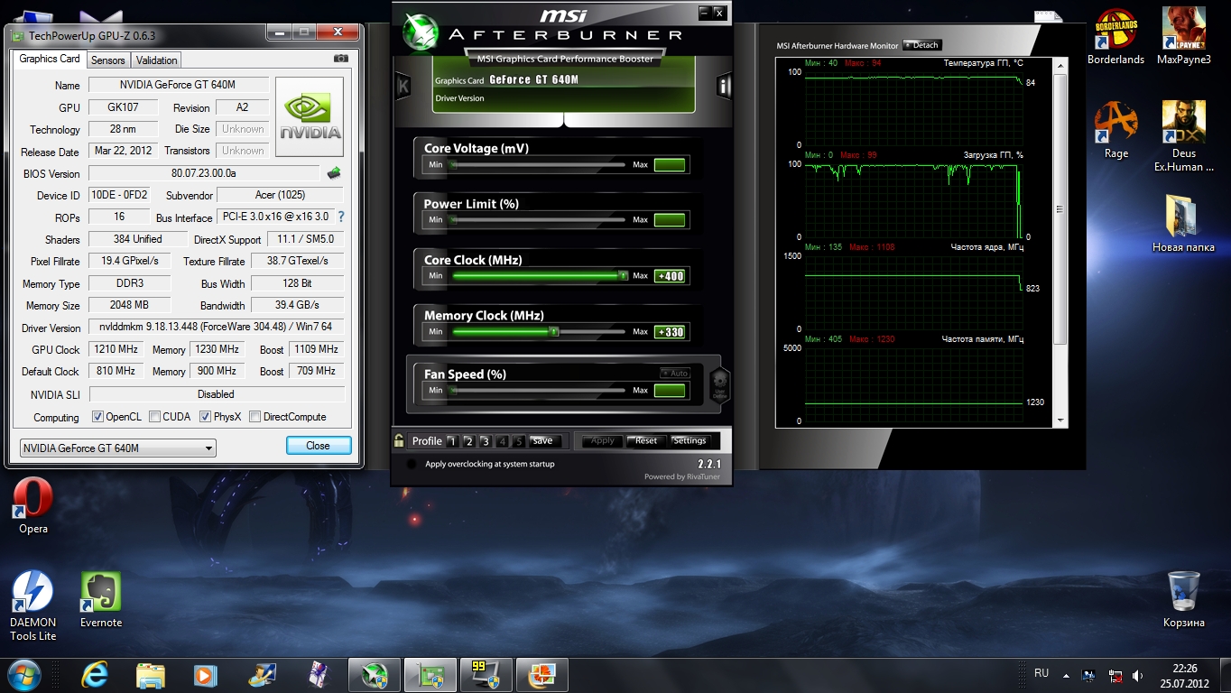

svl7 forgive me that i didn't answer to long, i was busy. So, like you asked there is a pic which shows the "graphics card" tab of GPU-Z and and overclocking tool with the sliders at max post-4385-14494993487214_thumb.jpg

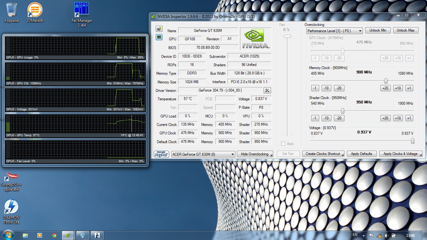

sl7 Is it normal that GPU Clock 810 Mhz and boost 709 Mhz? Here the screen.post-4385-14494993567284_thumb.jpg
Well, the boost doesn't work anyway at such clocks if I remember correctly, so it doesn't matter. The core should sustain 810MHz.
This might be caused by not enough voltage for such clocks. Does it happen in all games?
I don't have a system to test it myself, and the first guy who tested this BIOS said it was working well...
Not in all games. For example, the same problem i have with prototype 2 and Skyrim.
