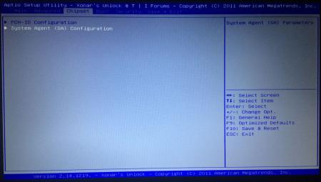

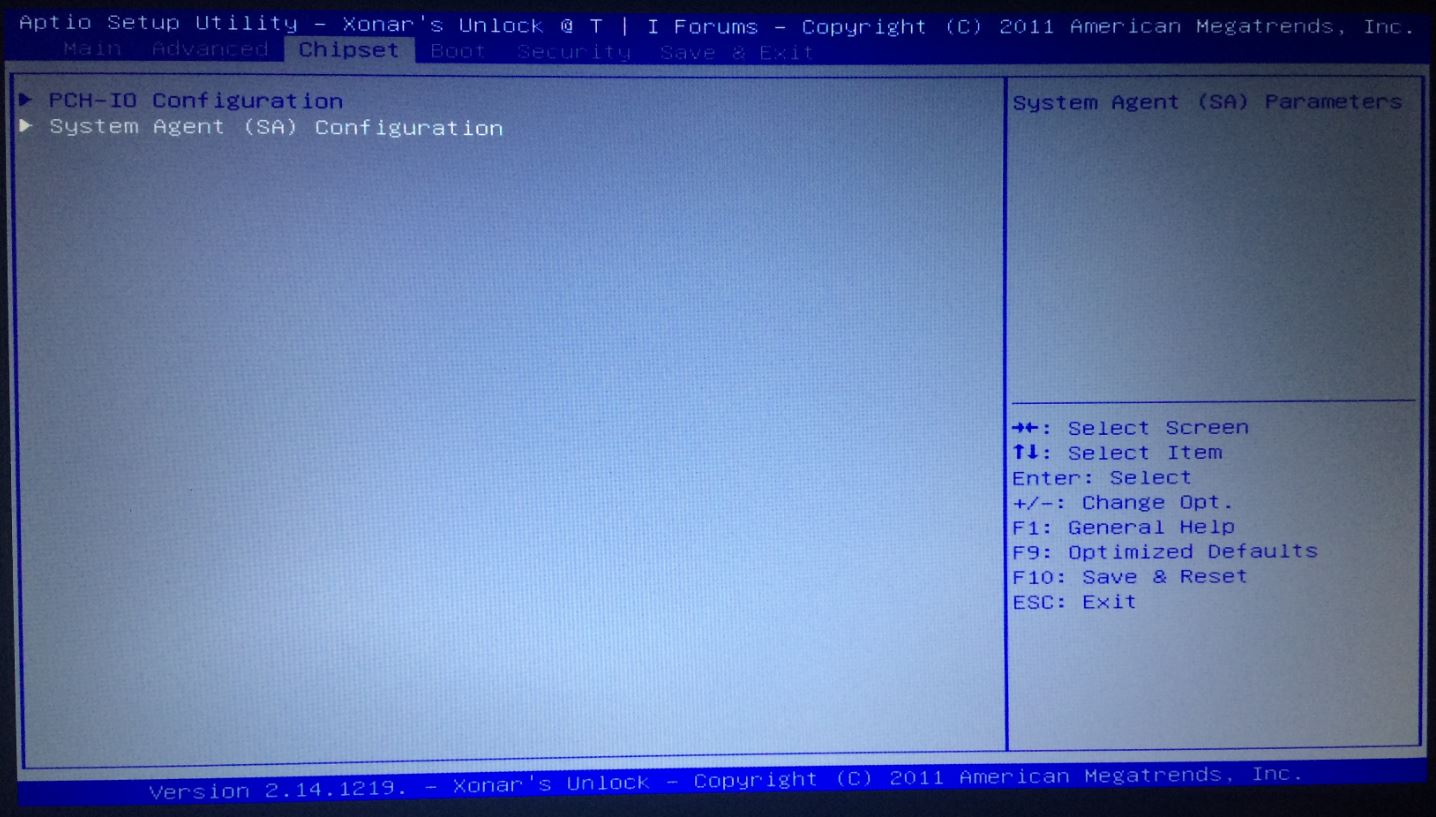

Could you please make a photo of screen in Bios Setup menu, on the page CHIPSET?

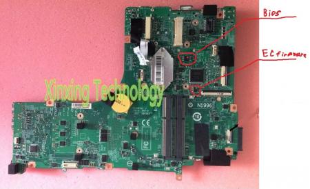

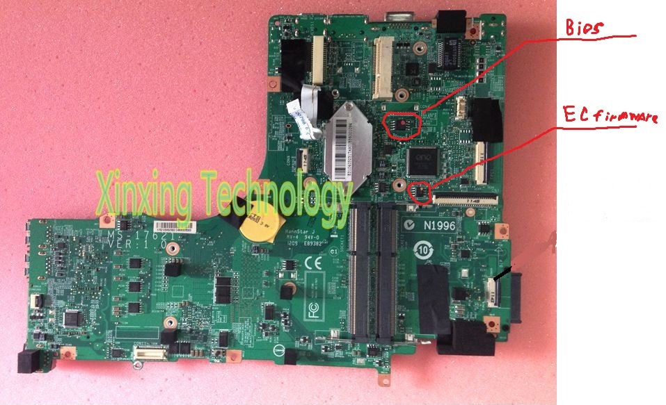

Hi there, I just want to ask something. The BIOS chip on MS-16F31 is W25Q32xxx - which means 32 bits or 4 MB. How is possible to flash with Eeprom programmer any Original BIOS from MSI site , because it is 8 MB !!!. Any hery badelp please , cuz I try to flash with wrong BIOS and now need to reflash with prgrammer, but was very bad surprised with this BIOS chip of 4 MB.
  • Bios Modder
You have found the chip for EC firmware (not for bios). Just search again. Both chips (for EC firmware and for bios) marked with color dot, chip for bios slightly larger.
  • Bios Modder
Yes, and this BIOS chip on mainboard is W25Q32xxx ( 4MB ) - but all BIOS files are 8 MB- how to flash it. The EC firmware is MX - 64 Kb.
May be someone replaced correct BIOS chip from 25Q64 to 25Q32? In any case now you can solder correct bios chip.
