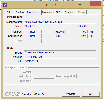

raven_ninety Posted October 27, 2014 Share Posted October 27, 2014 Post here file backup of your main system bios. How can I backup my system bios or is this the one below? This is the file I downloaded from MSI E16GFIMS.521 Quote Link to comment Share on other sites More sharing options...
Bios Modder Klem Posted October 27, 2014 Bios Modder Share Posted October 27, 2014 How can I backup my system bios or is this the one below?This is the file I downloaded from MSIE16GFIMS.521[ATTACH=CONFIG]12957[/ATTACH]No. You need create backup of your native bios, from your laptop. Not from MSI website. Quote Link to comment Share on other sites More sharing options...

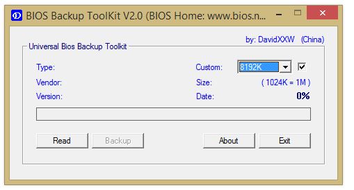

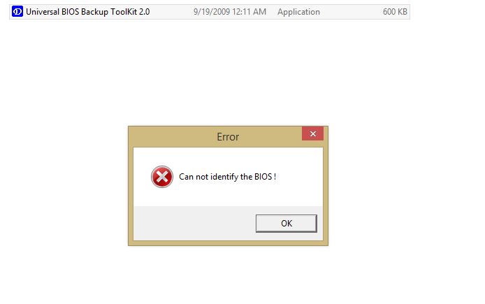

raven_ninety Posted October 27, 2014 Share Posted October 27, 2014 No. You need create backup of your native bios, from your laptop. Not from MSI website. I've used Universal BIOS Backup Toolkit v2.0 but its says after the warning the read button is disabled unless I checked Custom then set a size Is it safe to backup the bios just by checking Custom and setting the size to 8mb (same size of bios, I downloaded from msi)? If yes here it is after pressing Read then Backup msige602pebiosbackup If this is wrong is there a guide on how to backup the bios of msi ge60 2pe apche pro? Quote Link to comment Share on other sites More sharing options...
