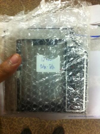

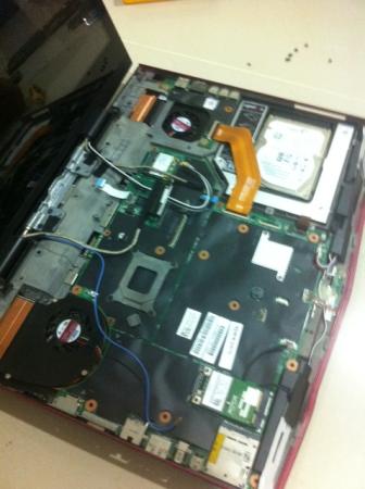

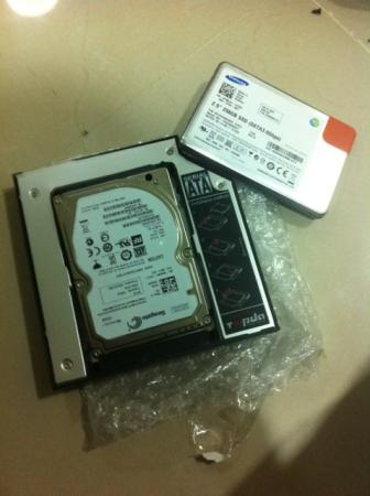

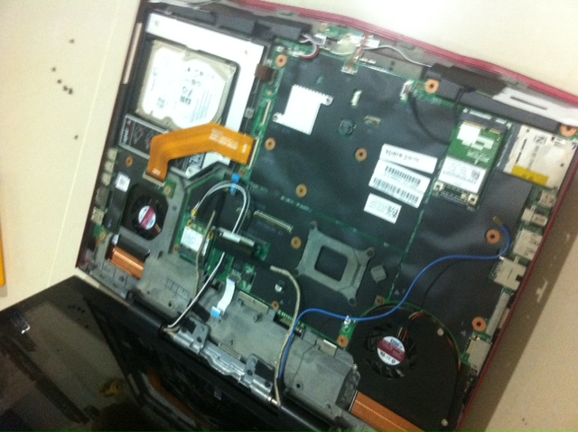

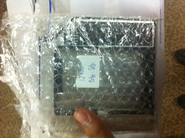

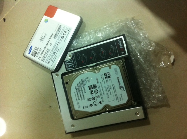

That would be off-topic here but i guess the moderator will understand about it. Yes i ditch the optical for one more HDD. I just bought external CD/DVD-RW for it via usb. Photos below is the work done to replace the optical for secondary hdd.
