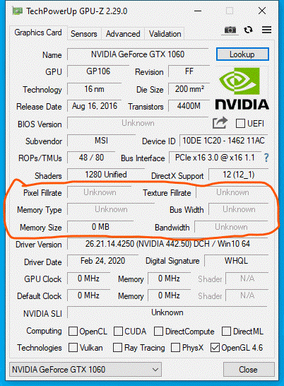

  5. Tried to access card with nvflash and i can read the serial number etc, i even flashed a new frimware successfully, so nvflash can easily access the card
  6. GPU-Z shows "unknown" in some areas but i guess thats because the drivers arnt loaded (screenshot attached)
I really don't know what to do now but i am sure something happened due to an update @Prema

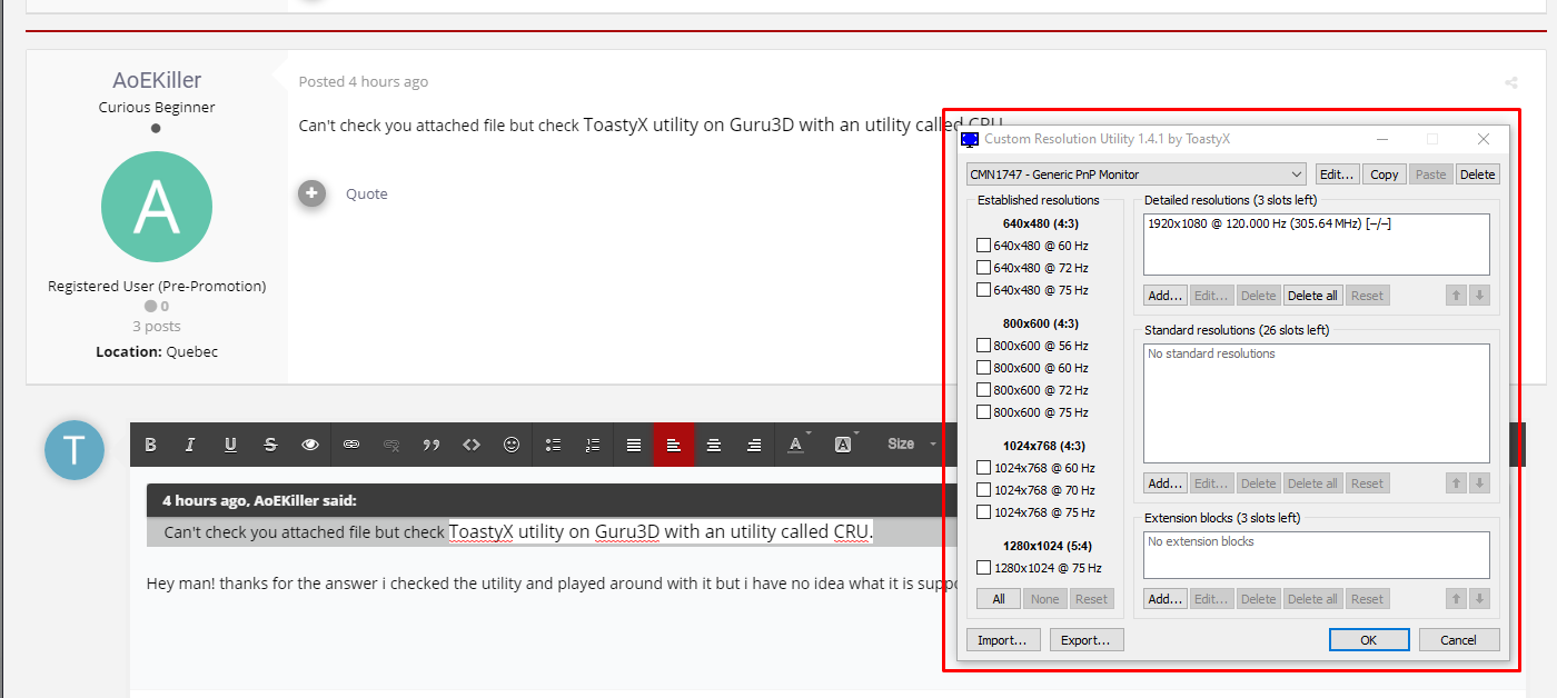

Can't check you attached file but check ToastyX utility on Guru3D with an utility called CRU.
Posted (edited)
Hey man! thanks for the answer i checked the utility and played around with it but i have no idea what it is supposed to do
By the way i used extron edid manager to make a backup and read the edid i shared
Edited by tazqa
