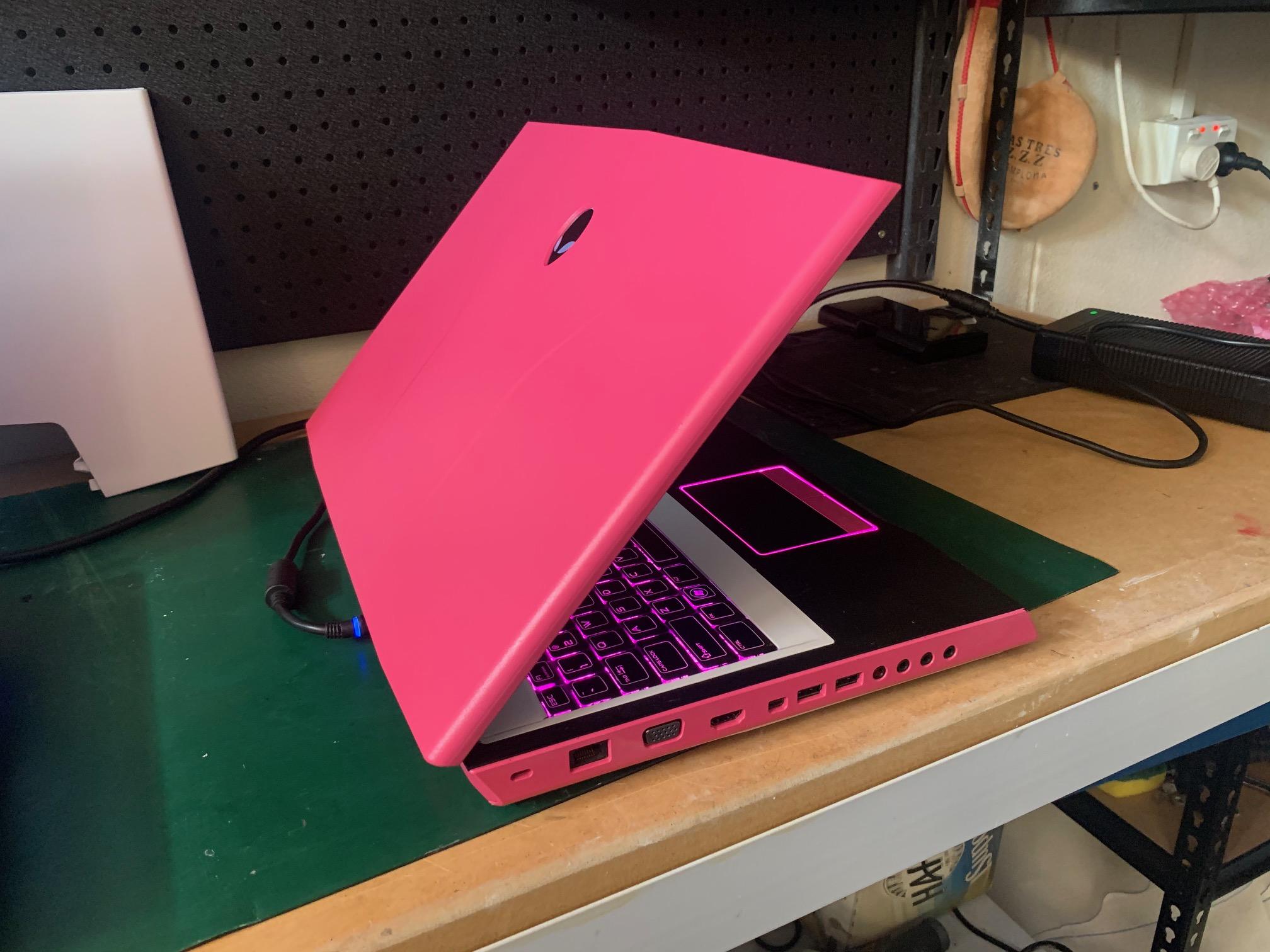

Refreshing my old M17x R3
  • 6 months later...
Hi MattyB, these old R3s are absolutely amazing! They can still hold their own even though they're 8 years old. I bought myself an old one a few weeks ago, and despite a few issues with win10 (such as audio drivers) I got mine running. That colour scheme looks great - did you paint it (and with what)?

Wow that's some sweet looking R3. Congrats on the paint job :thumbsup:

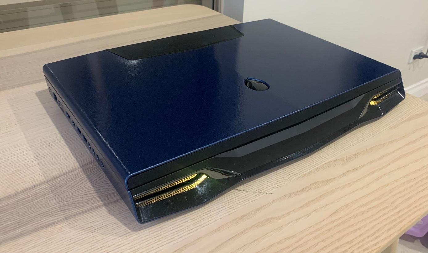

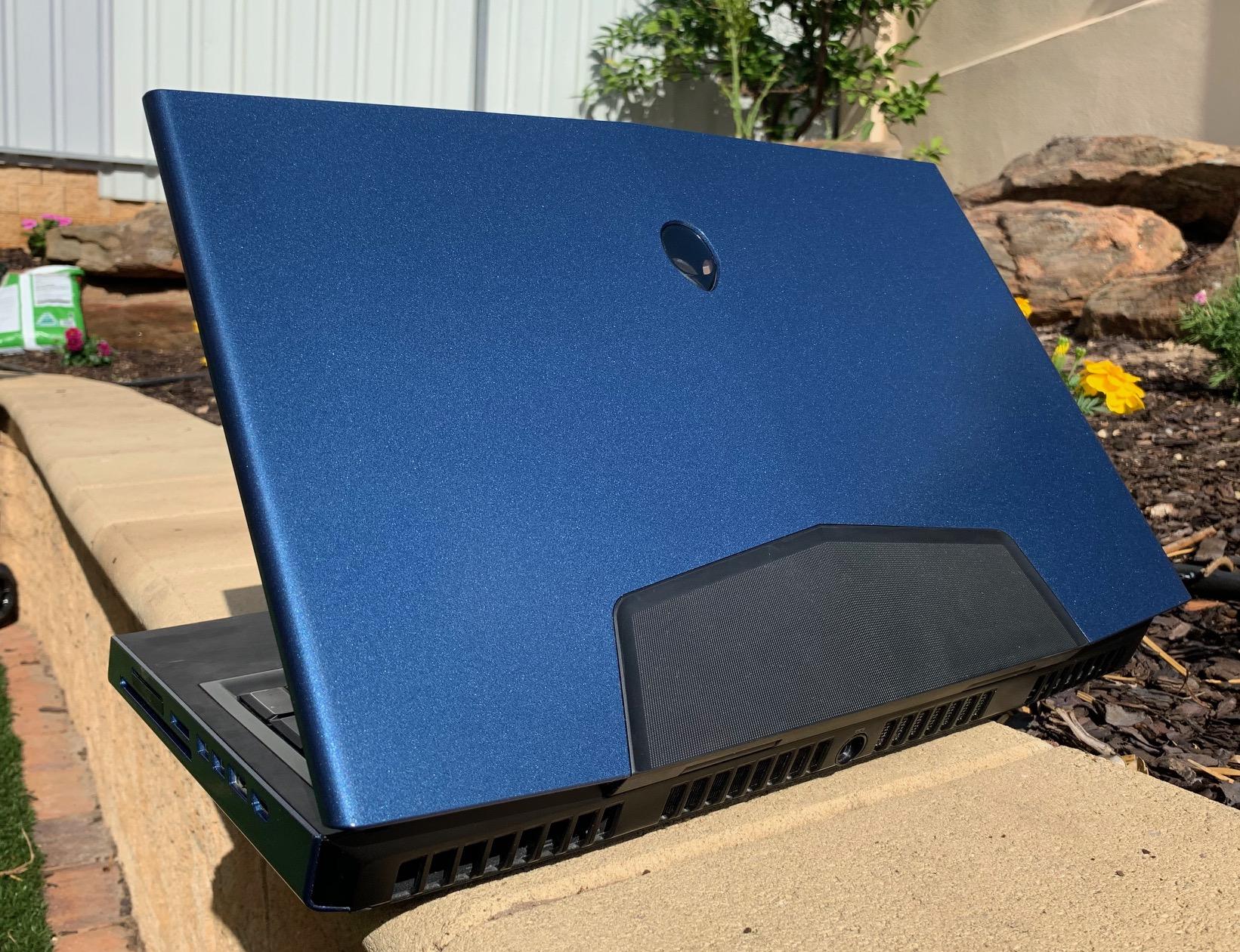

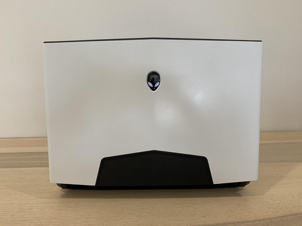

No problem. I just finished respraying an M18x R2 Gloss White and it took about 3 months because it kept getting tiny bits in the final coats. It was infuriating to say the least. I really need a cleanroom or spray booth especially for the colors that really show imperfections, like white. So far my best effort was on my personal M18x. It's a deep blue indoors and really pops in the sunlight.
