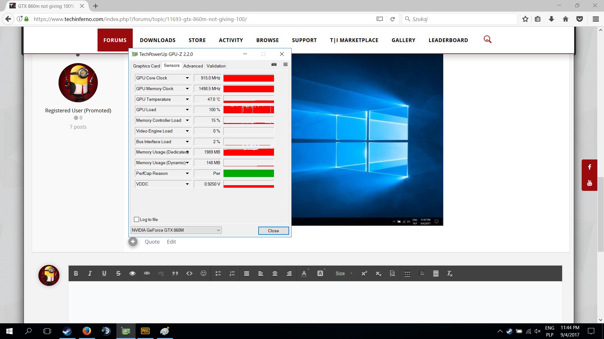

Well 860m came in two different versions,
GM107 witch is Maxwell based with 640 cuda cores and GK104 Kepler witch have 1152 cores
On screens shoot U posted i can see 915 MHz on core so if U didnt oc it should be kepler
But on the same screen i cant see any throtling core is stable so duno why u got worst results
