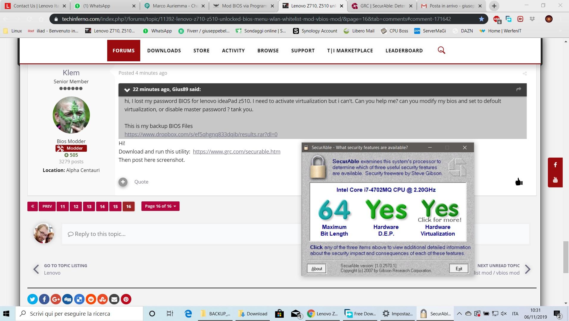

hi, I lost my password BIOS for lenovo ideaPad z510. I need to activate virtualization but i can't. Can you help me? can you modify my bios and set to defoult virtualization, or disable master password ? tank you.
This is my backup BIOS Files

  • Bios Modder
https://www.dropbox.com/s/ef5qhgnq833dqib/results.rar?dl=0
Hi!
Download and run this utility:  https://www.grc.com/securable.htm
Then post here screenshot.
  • Bios Modder
3 minutes ago, Gius89 said:
SecurAble utility show that virtualization already enabled.
Are you sure that Intel (VMX) Virtualization Technology disabled in bios?
