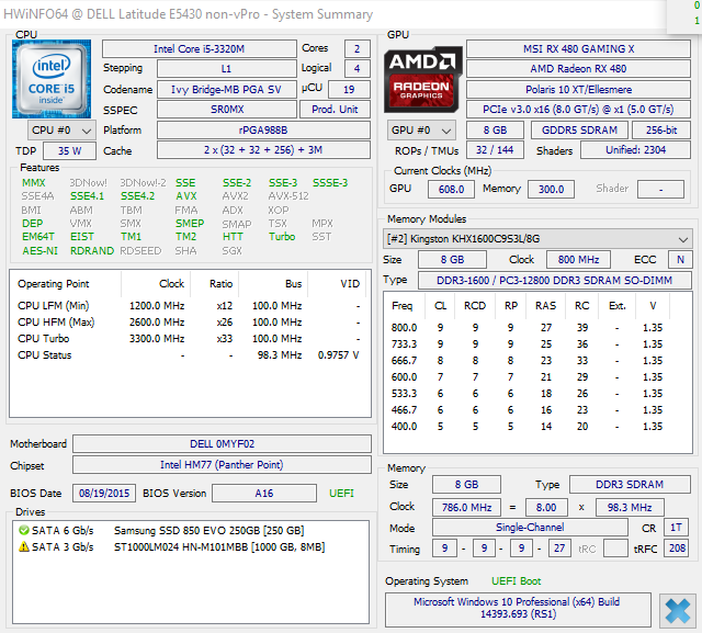

First, hello! Although I am new here, I have been a long time following this forum, and without all of you this hasn't been possible,so thank you!
  • System:
    • Hardware
      • Dell 5430 14"
      • Core i5 3320M
      • 8GB RAM (1x1600Mhz)
      • iGPU Intel HD 4000
  • Software
    • Win 10 Pro 64-bit Versión 10.0.14393 [UEFI]
    • GPU Driver AMD Radeon 17.2.1 (non-whql)
  • EGPU
  • Configuration
    • Just connect the egpu to PC via ExpressCard (PSU ON & PC Off), turn on the PC, and GPU was detected and it worked. [PTD: Off]

  • Hardware Info:
    • Spoiler

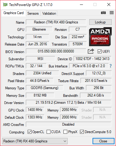

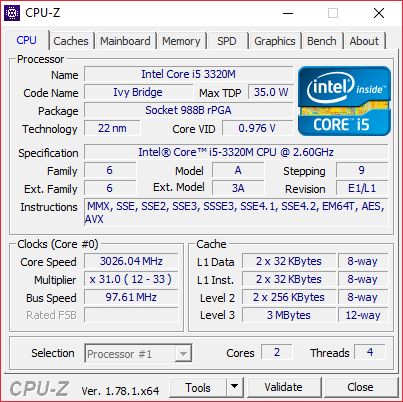

      GPUz & CPUz:

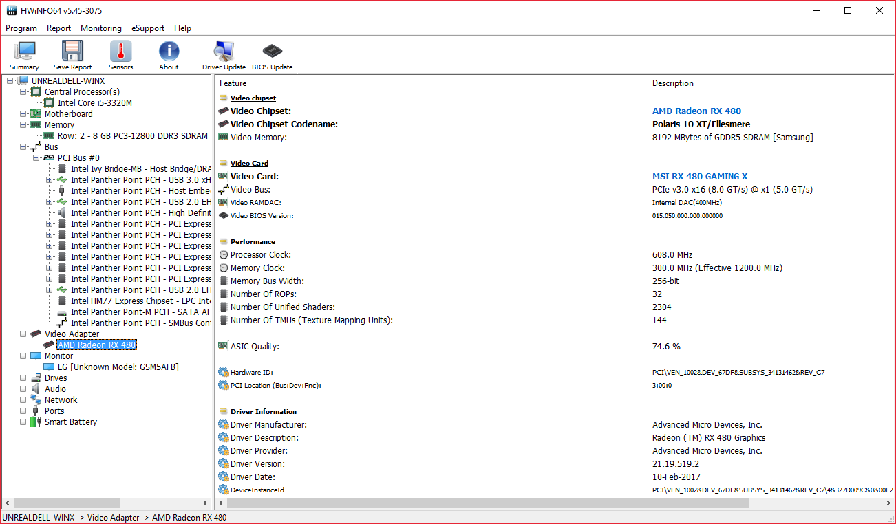

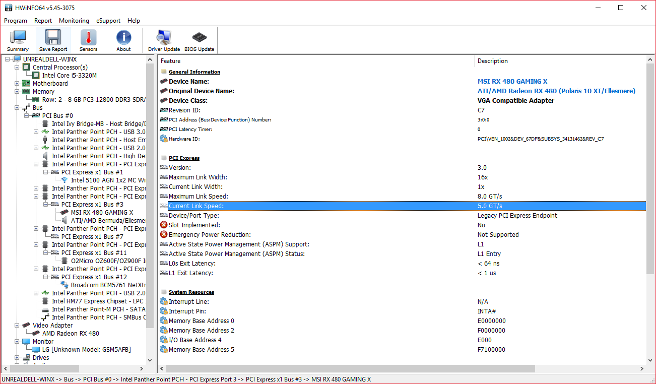

      HWInfo (GPU & CPU)
      HWInfo (GPU)
      HWInfo (Bus GPU)

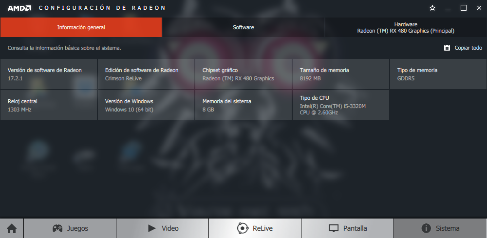

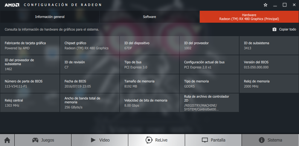

      AMD Config:

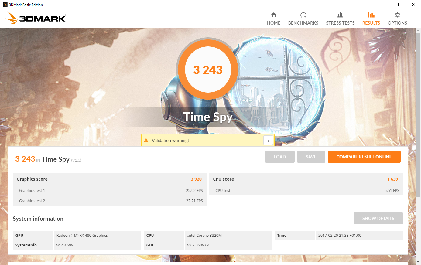

    • 3DMark TimeSpy 1.0 3242 (GPU:3920) http://www.3dmark.com/3dm/18115631
    • 3DMark FIRE STRIKE 1.1 7375 (GPU:12996) http://www.3dmark.com/3dm/18115814

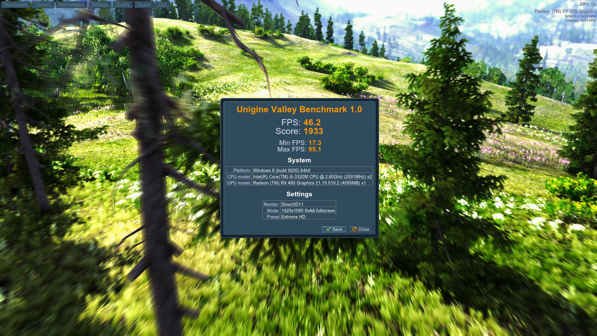

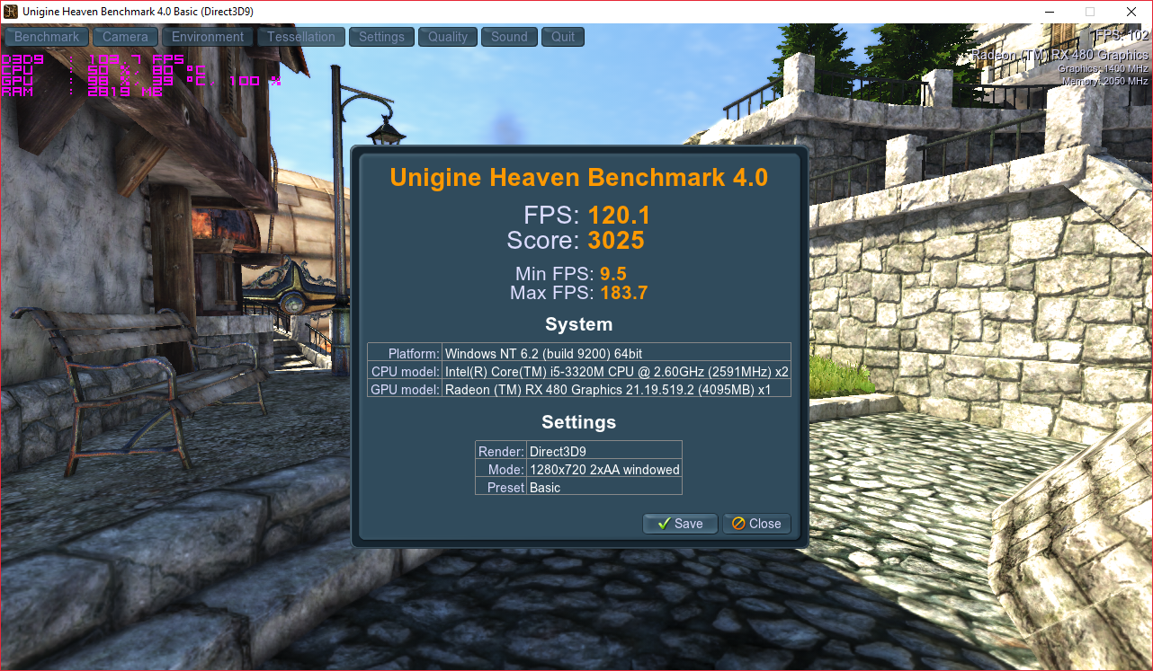

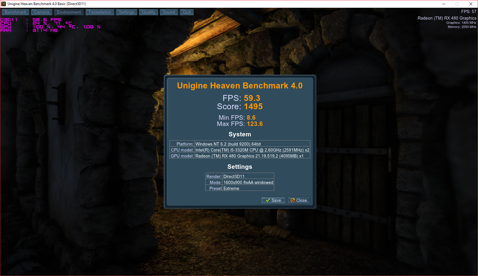

    • Ungine Heaven 4.0 [Basic]: 3025 [Extreme]: 1495
    • Ungine Valley 1.0 [Extreme HD]: 1933

  • Screenshots Bench:
    Spoiler
