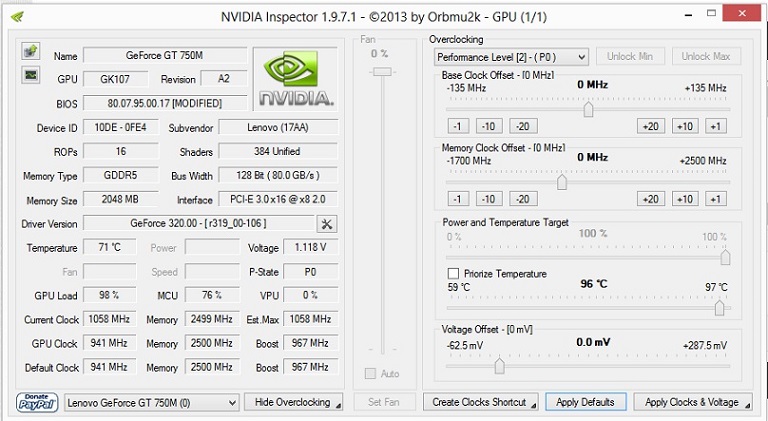

I recently tried this Lenovo IdeaPad Y500 bios mod by svl7.  I was originally running official Insyde Bios v2.02 and the stock vbios for the first graphic card GDDR5 750M. I was reluctant to try this bios mod initially because I could not backup the vbios for the first 750m graphic card, but I finally decided it to try it because I was convinced that I needed access to other hidden bios options to accomplish what I was trying to do.
I wasn't modding my bios so I could change the GPU clocks of my 750M graphic cards, and I did try to back up the vbios for each 750M first. If I tried to back up the vbios with GPU-Z, it would give me an error message saying bios reading is not supported, cause my computer screen to change colors, or freeze my computer completely. If I tried it to back up the vbios with NVFLASH, it would change my display resolution, disable my GPU, return an error message, and cause NVIDIA control panel to return a message which says a NVIDIA GPU must be attached to the display, etc. I could only backup the vbios for the second GPU.
I followed the instructions on the guide posted on the TechInferno forums correctly and everything. I backed up my bios, modified it using the tool, and then I flashed the modded bios. The bios mod was successful, and I now had access to other hidden bios options. However, I noticed that the vbios version for the first 750M GDDR5 graphic card was now different as I had feared, and it was also clocked at 1059 mhz, almost 100 MHZ higher than it was before the mod (it was at originally at 967 MHZ).  The original vbios version 80.07.95.00.17 was changed to version 80.07.9d.00.11.
Here are some other GPU-Z validations for reference:
vbios 80.07.95.00.17:
https://www.techpowerup.com/gpuz/details/e7hcb
https://www.techpowerup.com/gpuz/details/3yyyu
vbios  80.07.9d.00.11:
https://www.techpowerup.com/gpuz/details/4z7pe
The GPU clock was higher (1059 mhz) for me with the 80.07.9d.00.11 version. I did a Futuremark benchmark in SLI, but I got the same/similar results as before.
But the computer seemed to running fine with the SL7 bios mod, despite the change to the vbios for the first graphic card.

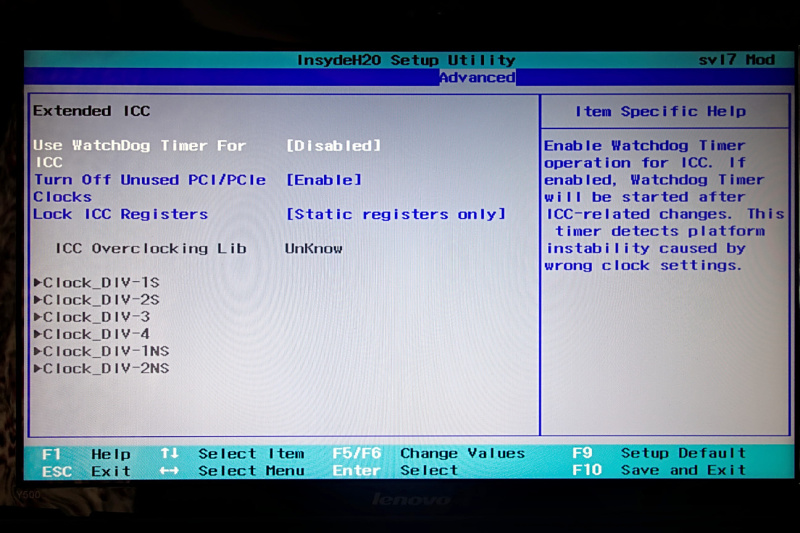

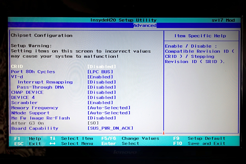

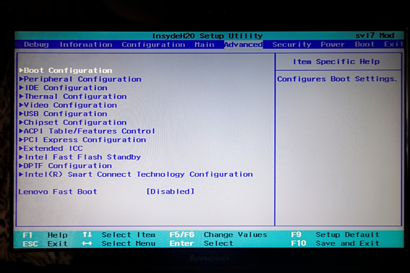

I tried enabling and disabling various features and options in the bios, but none of them seemed to get what I wanted working. If the PC was stuck at the Lenovo logo after changing an option, or something else wasn't working right in Windows after making a change in the bios, I just undid the changes I had made previously in the bios.
One thing I noticed after I installed the bios mod was a command prompt which opened up and installed some WiDi certificate while I was running Windows 10.
I decided to press escape a few times while the Lenovo logo was displayed, and I noticed that it took me to some Grub4Dos boot menu, with gave me a list of options of booting Windows with or without SLIC, etc. I was never able to do this until I installed the modded bios v2.04, and I'm pretty sure I never actually installed Grub4Dos myself.

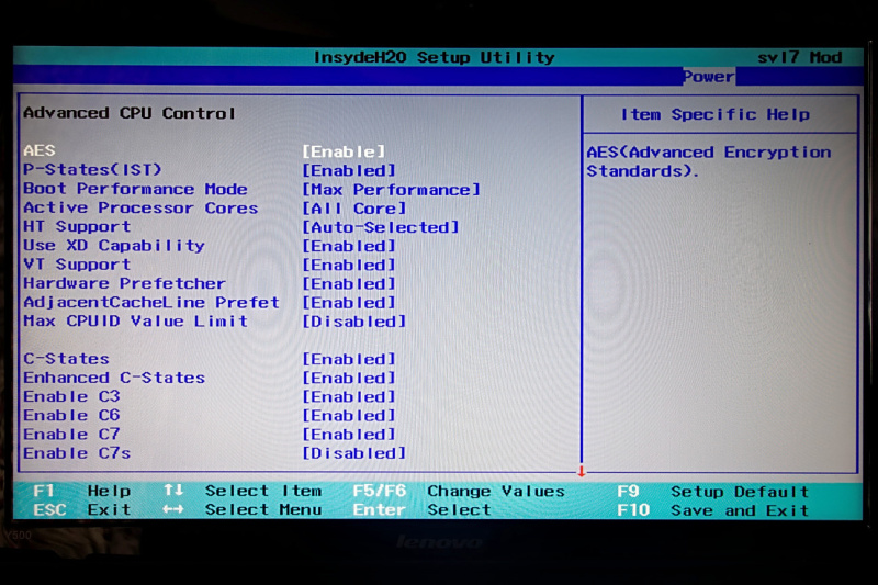

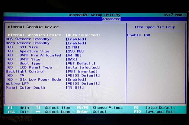

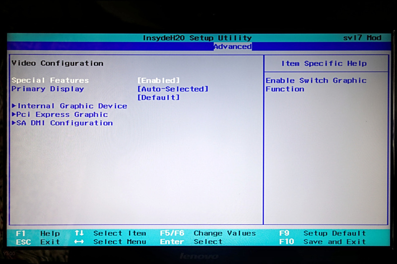

I tried experimenting with various bios settings in the video configuration which was accessible in the advanced section of the boot menu, but changing these options didn't suffice.
So, I decided to enable the Intel Smart Connect Technology and the Intel Dynamic Platform and Thermal Framework (DPTF) in the bios. A bunch of unknown devices showed up in Device Manager when I booted Windows, so I went ahead and installed the Lenovo Smart Connect software which was for a different Lenovo Laptop as well as the Intel Dynamic Platform and Thermal Framework drivers that were for a Lenovo Yoga. Both installations worked and installed drivers for the unknown devices.

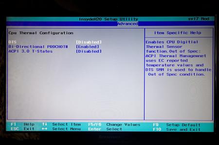

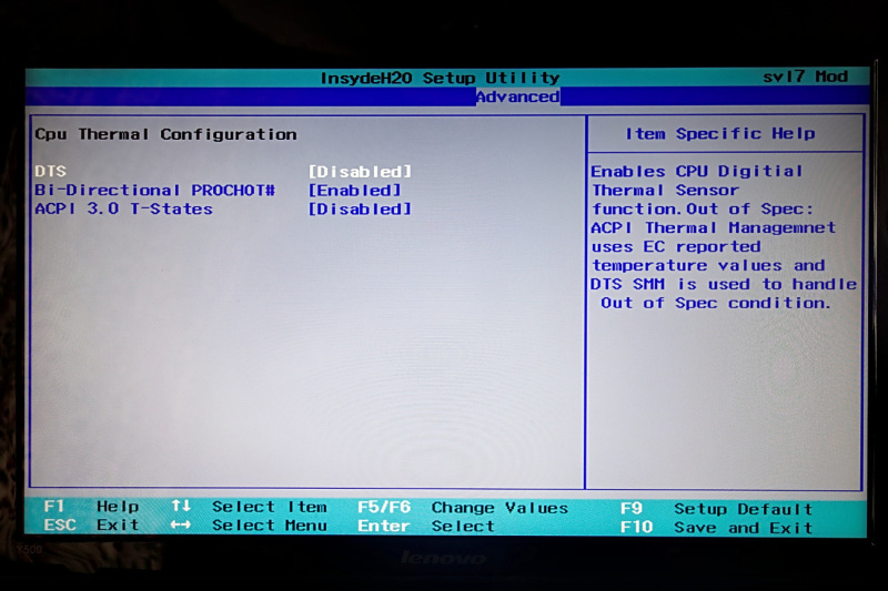

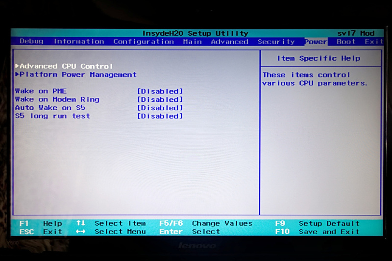

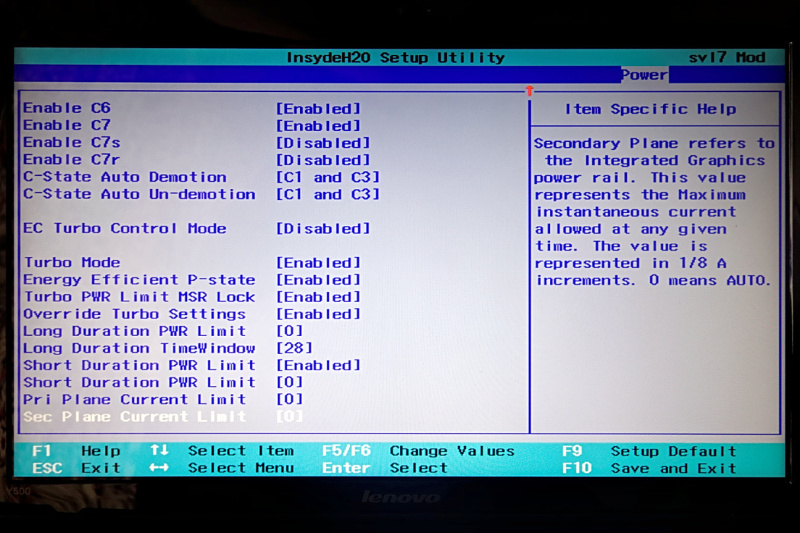

I took of some options for the CPU which stood out to me. I saw that the "Bi-Directional PROCHOT#" in the thermal configuration of the advanced section of the bios, was enabled, but I didn't disable it. If this is enabled, it kinda makes the Intel Turbo Boost feature useless because the CPU Turbo Boost clock to 3.4 ghz etc. will only last a couple of minutes and maybe longer if you are lucky since the CPU cores will reach temperature maximums by that time. If Intel Turbo Boost is enabled at the same time, the Bi-Directional PROCHOT setting can also cause CPU-demaning games to freeze and lag. But the BDPROCHOT setting in the bios isn't something that you cannot disable in Windows using an external overclocking program if you want the the extra benefit of the Intel Turbo Boost, so it wan't really necessary to disable it in the bios.

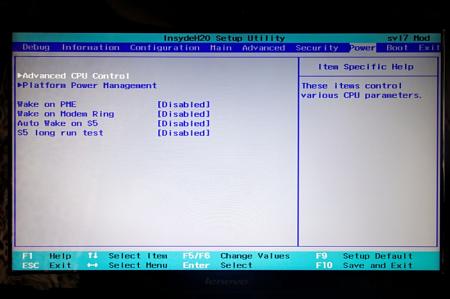

I did see that there was an option to disable the hyper-threading for the CPU somewhere in the power section of the modded bios, so I gave it a spin. I once wanted to reduce extra  CPU threads without actually disabling physical cores of the CPU by disabling hyper-threading, and I could not do this until I installed the modded bios.

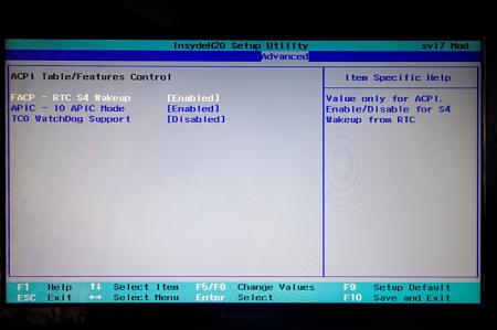

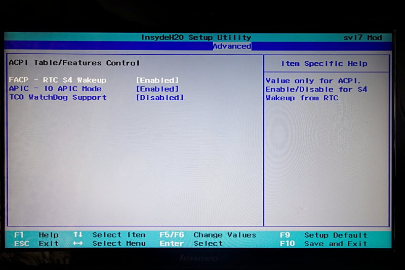

I was interested in the ACPI Table/ Features Control in the advanced section of the bios  as well, and I enabled the TC0 Watchdog Support which was originally disabled. It changed some configuration in Windows and required a reboot of the operating system. Changing this setting in the bios didn't seem to cause any problems.

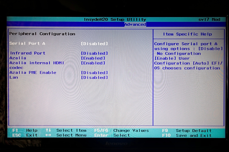

I enabled Serial Port A in the Peripheral Configuration of the advanced section of the bios, and I'm not sure what this did.
I also disabled some PCI clockrun setting as well. I believe it was the turn off unused PCIE/PCI  clocks in extended ICC in the advanced section of the bios.

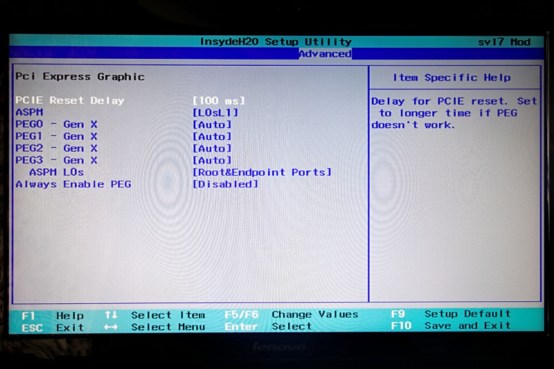

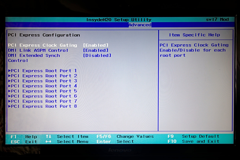

Finally, I decided to change a setting in the PCI Express Graphic in the Video Configuration which was part of the advanced section. The setting was called "PCI Reset Delay". I changed the setting from "100 ms" to disabled. Now I cannot even access the bios of the laptop. The laptop powers on, but all I get is a black screen. I cannot get a video output using an external screen.

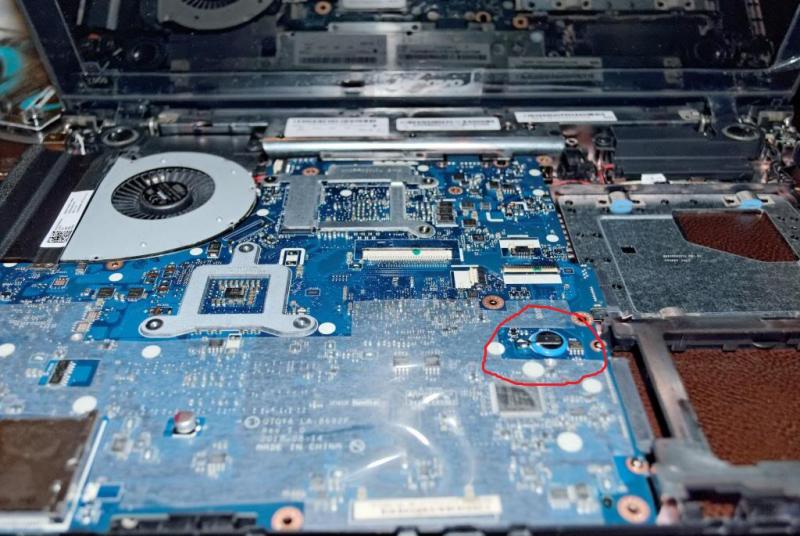

Here is a visual representation of the CMOS Battery in question that may be soldered to the motherboard. I believe the CMOS Battery for the Lenovo IdeaPad Y500 should be located in the area circled in red:
This isn't an actual picture of my own Lenovo IdeaPad Y500's motherboard. The original photo was from the Y500 disassembled (pictures) thread:
I have yet to try fully disassembling out again to try and remove the CMOS battery for 10 minutes out of the fear of physically damaging the laptop. I have tried booting from a USB drive and the draining the battery bios reset method, but I have had no success so far.

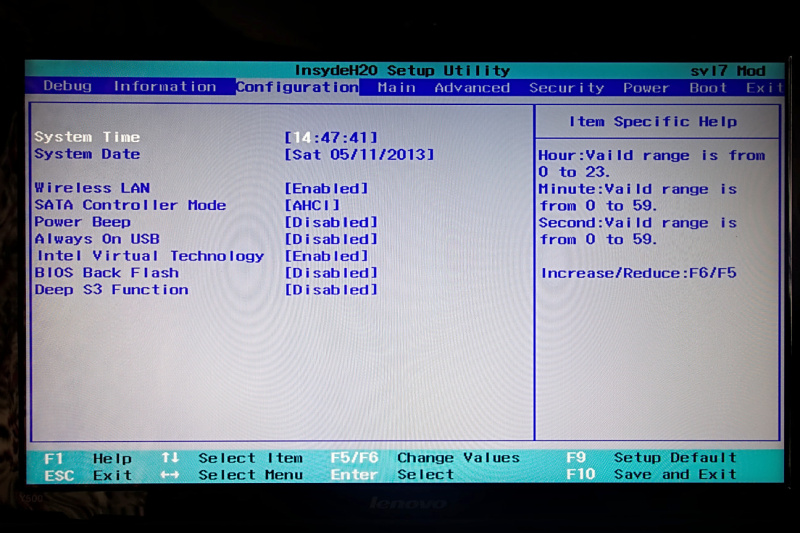

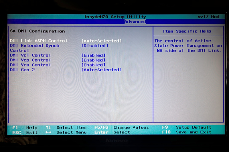

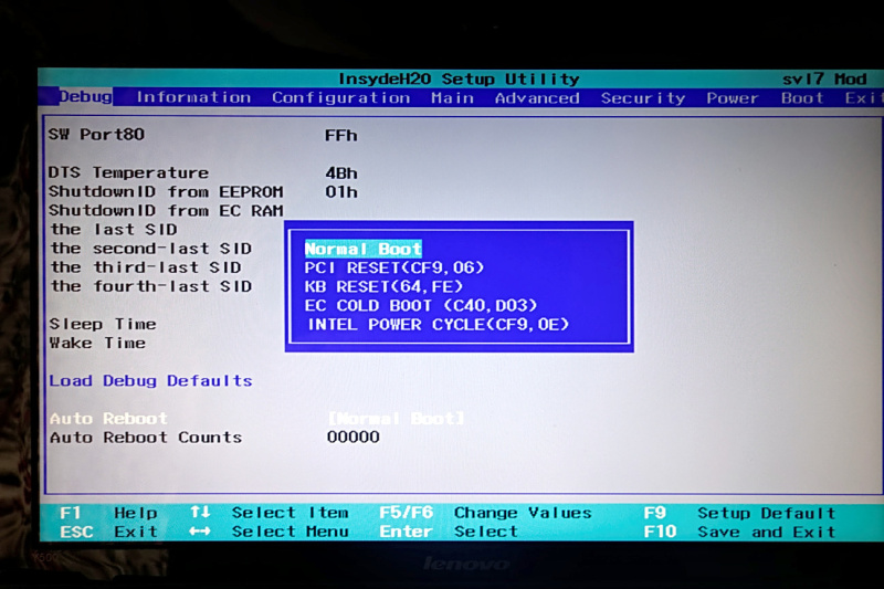

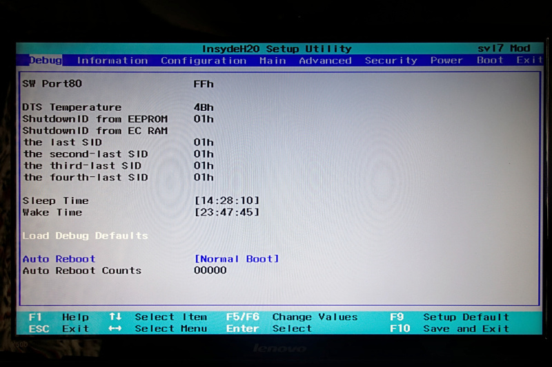

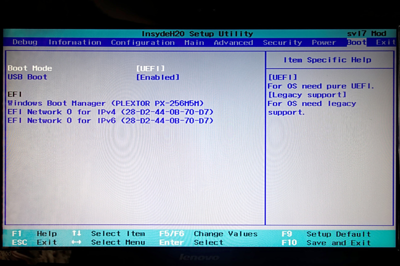

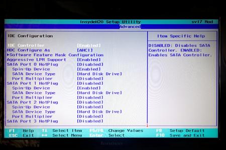

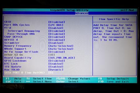

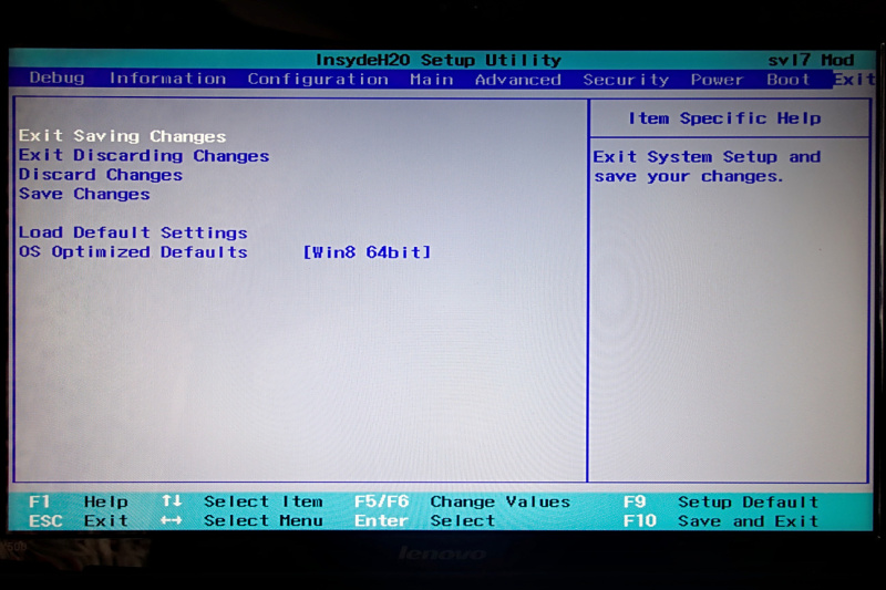

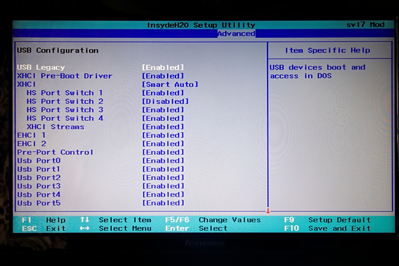

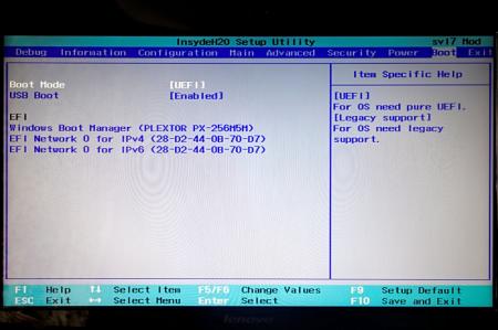

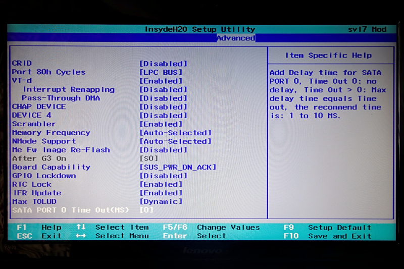

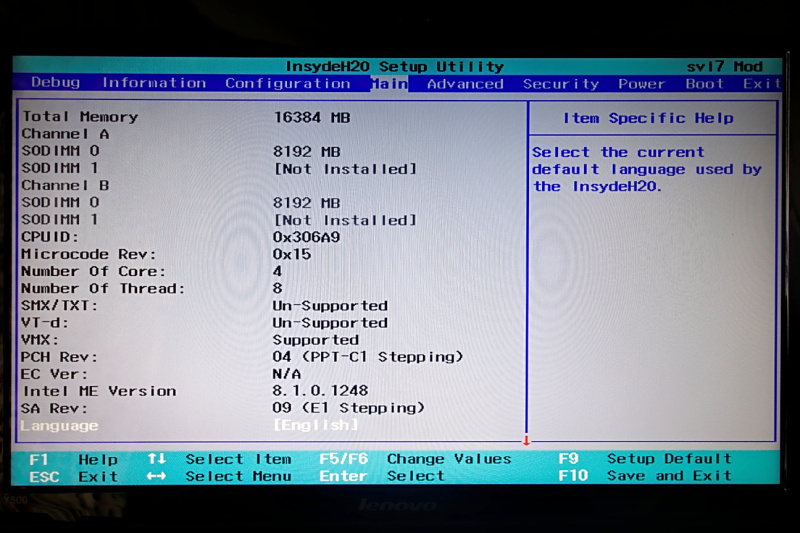

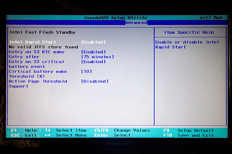

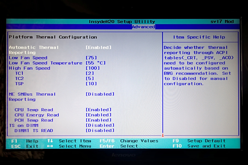

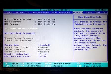

Prior to changing settings after installing the bios mod for my Lenovo IdeaPad Y500, I decided to take some pictures of the original settings. I didn't take any photos of the Power section of the bios, but the only setting that I changed there had to do with the Hyper-Threading for the CPU. I can't upload the images directly to this thread because they exceed the limit of 1 MB, but I uploaded them to PostImage, and here is the link to the gallery:
https://postimg.org/gallery/jiuaqrq6/
Hey. I have the same situation. I have included a graphic processor core. black screen. reset bios too can not. rosiyskih forums on the same nobody knows what to do. where else to look for a topic?
Someone took some pictures of their modded Lenovo IdeaPad Y500 bios and posted them to Svl7's Y500 unlocked bios guide a few years ago:
You can compare those to the pictures I posted of my own, and as you can see that my pictures are of the original modded bios configuration before I made changes to it.

"Hey Svl7, I tried this Lenovo_Y500_BIOS_v2.02_Mod - rev01.zip and the GPU 0 (main GPU) still have the +135MHz OC limit, as shown in EVGA Precision.
The Y500 - Y400 - SLI 750m - 80.07.95.00.17 - OC.zip works fine for GPU 1 (secondary SLI GPU).
What is weird is that before this GPU0 would go up to 1102MHz, but after flashing I believe it went up to 1189MHz in game. On the other hand, after flashing GPU1 would go above 1200MHz easily.
After checking with Nvidia Inspector, both GPU 0 and GPU 1 has the same BIOS (80.07.95.00.17), which says MODIFIED beside it.
I have tried re-flashing and GPU0 still wouldn't go above 1189MHz, meanwhile GPU1 went up to 1254MHz stable."
That user said that the second vbios for the secondary SLI GPU was the same as the first vbios for the main GPU (the 80.07.95.00.17 version) , but in my experience the second vbios for the secondary SLI GPU was different from the one that was used for the main GPU. The secondary SLI GPU vbios version ended in "1A". I have a backup of the unmodified, stock "1A" version.
I believe I did use the Phoenix tool once to try and get the main GPU vbios extracted from it, but I had some trouble identifying it. If I can take a look through those files again, I'll look for some files that are around 159 KB in size.
I'm not sure whether or not flashing a different vbios caused the issue I'm having with my laptop.

I still haven't tried removing/desoldering the CMOS battery from my laptop and resoldering it to the motherboard to try and do a bios reset. My problem is similar to what is described by some other posters:
If I manage to reset the bios by desoldering the CMOS battery and resoldering back to the motherboard and it works, I will let you know.
I think this happened to my laptop because I disabled the PCI reset delay. I messed around with some other settings that deal with video configuration like Primary Display (iGFX, PCI, PEG, SG, etc.) and Always Enable PEG, but I would still manage to get the Lenovo boot logo and be able to access the bios nonetheless. Some Video settings in the bios would revert back to the original when I changed them. It was only until I decided to disable the "PCI reset delay" did the laptop decide to become unbootable and not show anything on the display. I can get power from the USB ports, but I can't boot anything from them, and I'm wondering if the disabled "HS Port Switch 2" under "XHCI" in the "USB Configuration" of the "Advanced" section has anything to do with it. I have tried pressing the Novo button on the laptop, but nothing has ever happened when I have tried this.

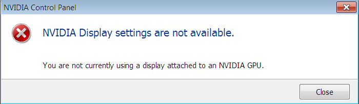

Here is the a picture of the NVIDIA Control Panel error I got after trying to get a vbios backup of the first 750M GDDR5 GPU attached to the laptop's motherboard:

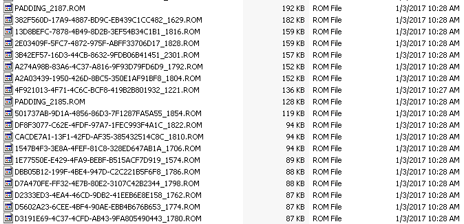

Here is picture of some files from the dump of my laptop's bios:
I read some tutorial online somewhere and dumped the bios using the Phoenix tool sometime ago, but I couldn't find the vbios. Perhaps one of these files listed above is the vbios for the first 750M GPU? I used my own laptop's original bios when I used the SVL7 Bios Fixer tool, so if the vbios isn't in the Phoenix dump of my laptop's bios, then how come a different vbios was flashed when I flashed my SVL7 modded bios to the laptop?

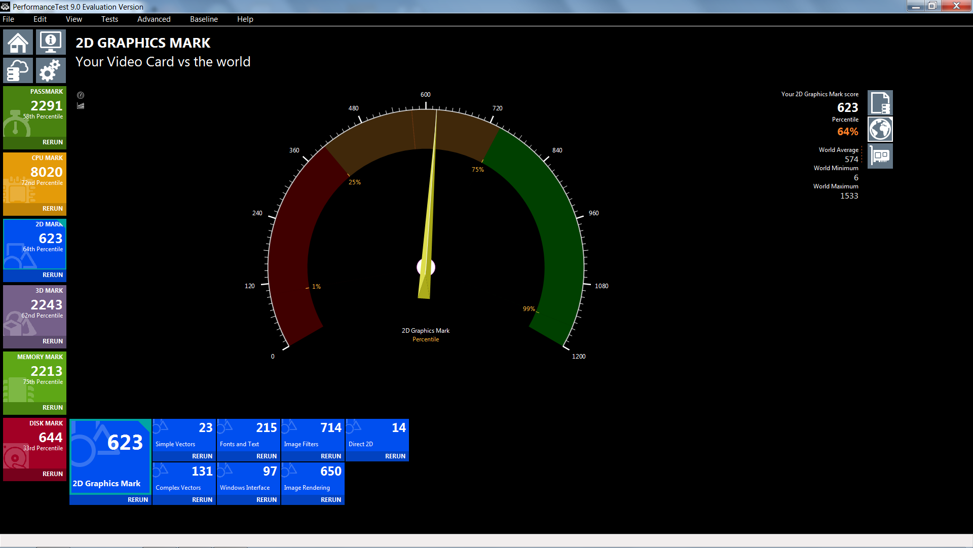

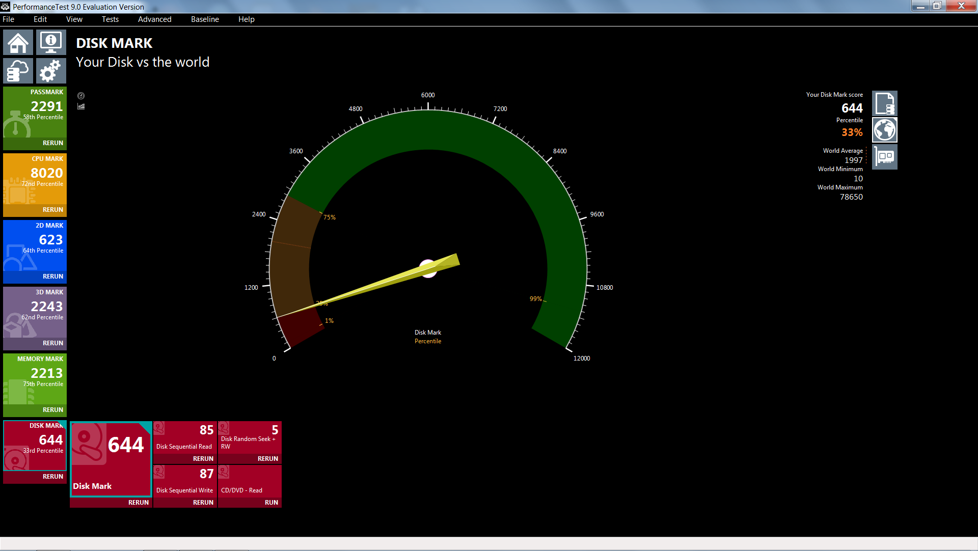

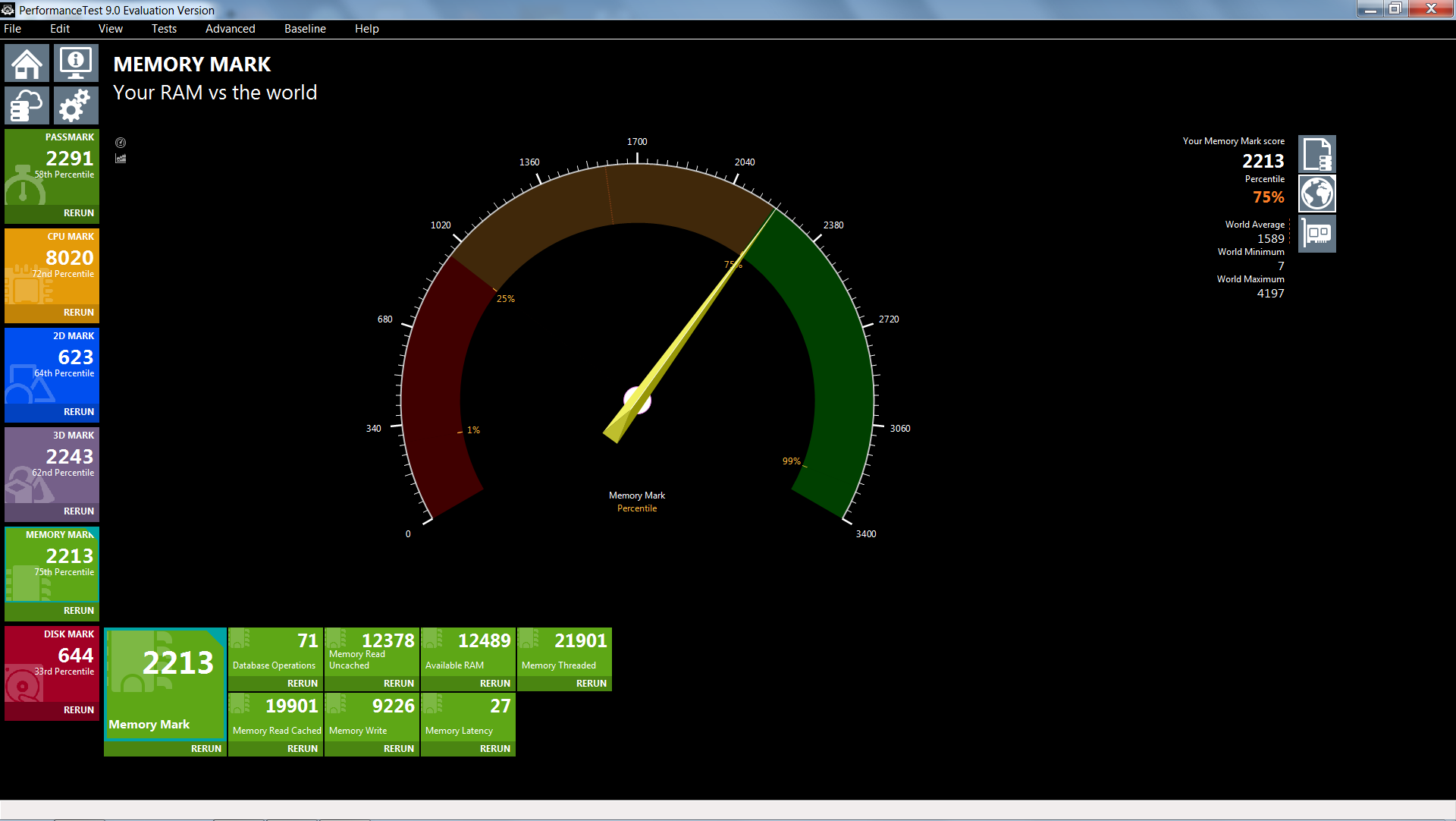

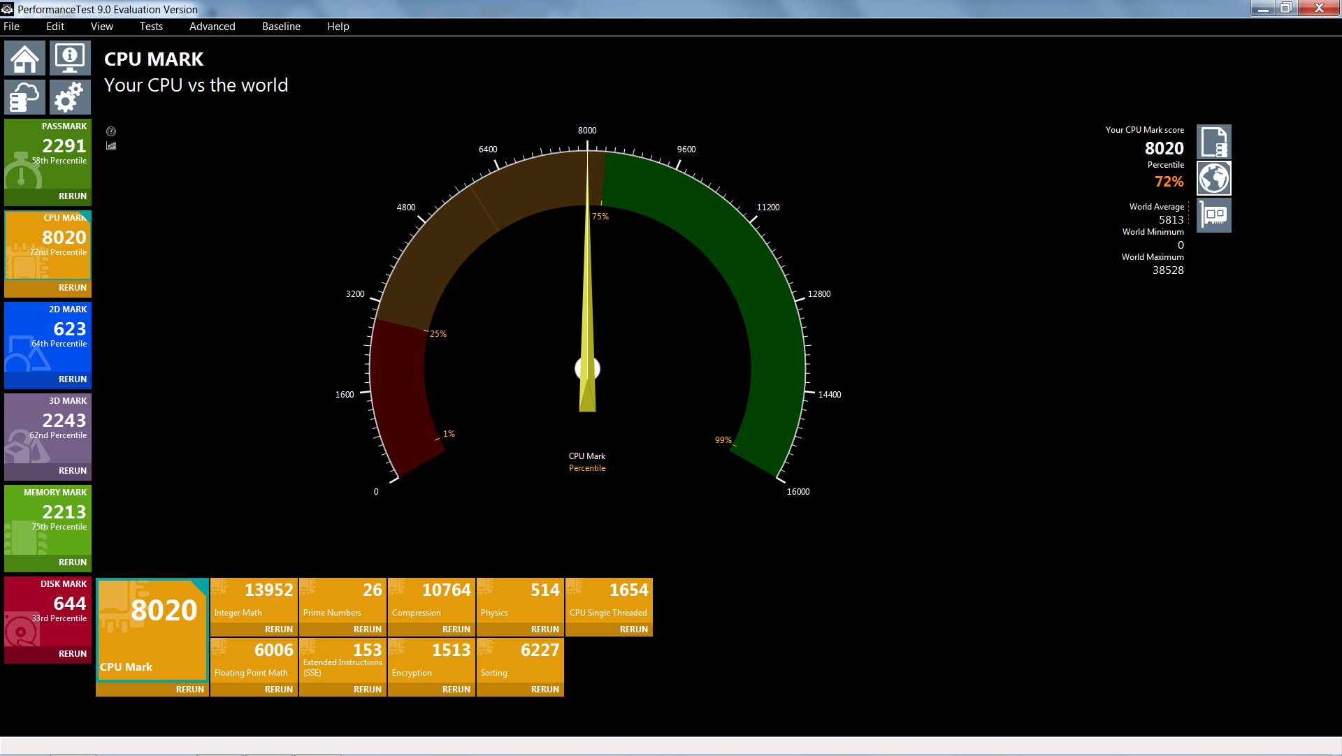

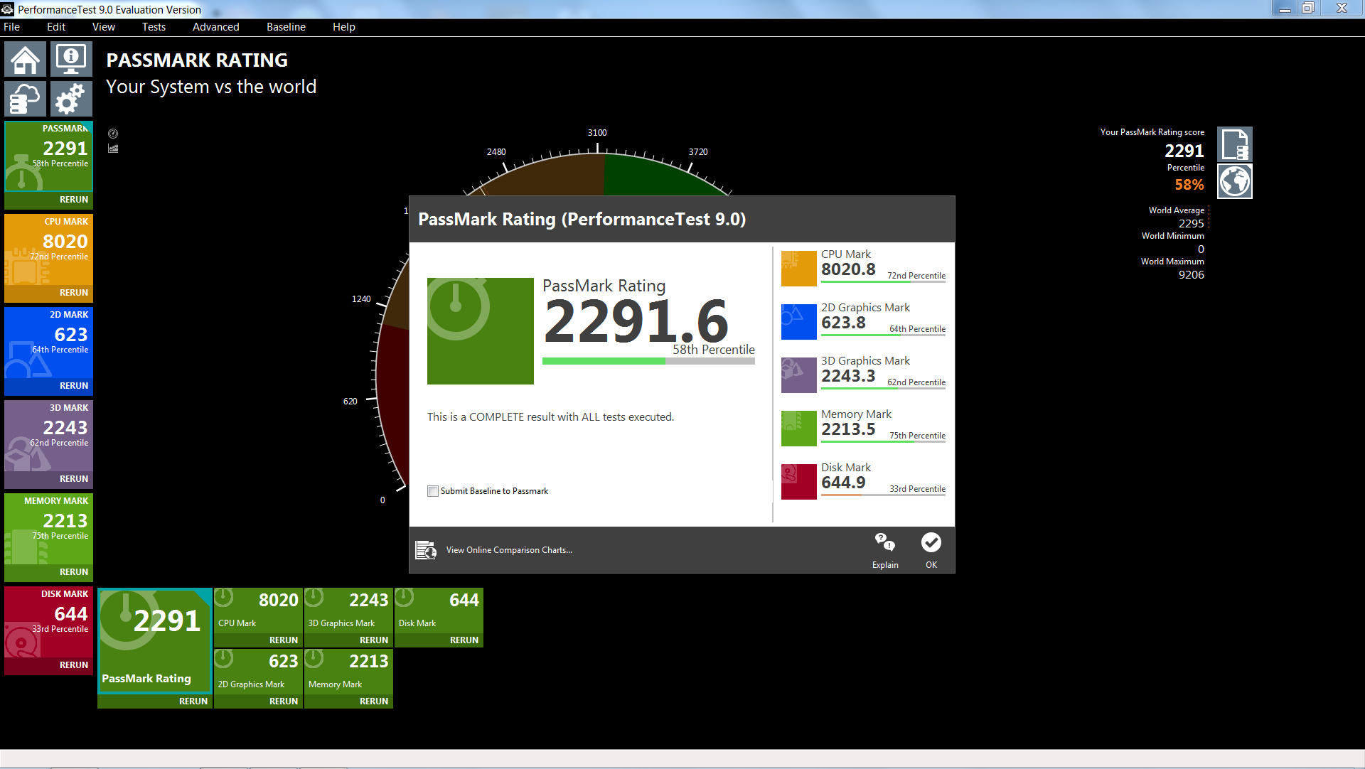

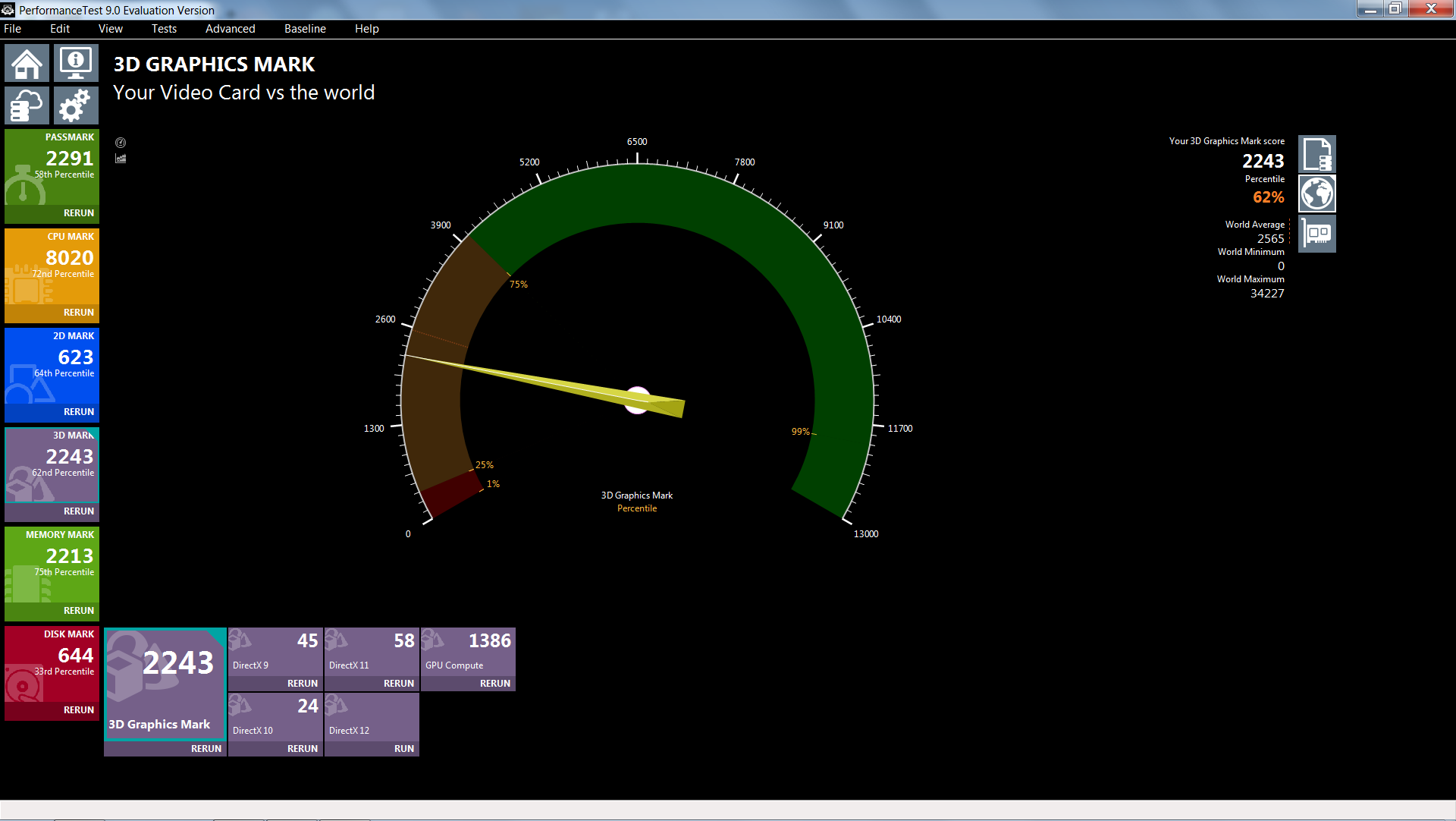

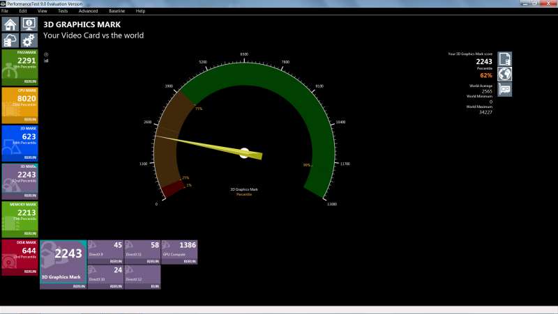

I did a Futuremark benchmark weeks before I did the bios mod, and I also did some Passmark performance tests a week after that.
The Futuremark benchmark was done on December 30th, 2016: http://www.3dmark.com/3dm/17053334
I was using an outdated version of Futuremark because I don't think a proper scientific assessment can be made if you change too many variables at once (graphics card drivers, CPU clocks, etc.). I did another Futuremark benchmark after I did the bios mod, but I didn't save the link to it. I noticed that the core clock says it is 1058 MHZ in the December 30th benchmark, but I never saw that speed in GPU-Z (I saw 967 MHZ boost clock speed) while using the 80.07.95.00.17 vbios in Windows for the first 750M GPU, hence that is why I thought I got a 100 MHZ overclock when the new 80.07.9d.00.11 vbios replaced it. I guess the GPU clocks change depending on what you are doing. I found this in another thread:
Here are the Passmark benchmark screenshots I saved from January 7th:
PassMark3DGraphicsMark.pngPassMark2DGraphicsMark.pngPassMarkCPUMark.pngPassMarkDiskMark.pngPassMarkMemoryMark.png
I think the 3D Graphics Mark is twice as high as the 750M you will see on PassMark's website because I was doing the test in SLI. I never submitted my results to Passmark.
