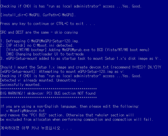

i  running setup_disk_image but have warning massege what can i for this steps?
*Macbook pro retina 2013 early (gt 650m)
*Windows 10
*Setup 1.2 by  @Tech Inferno Fan
*Using language is korean.
*see attached image and index in devcon.txt
thanks.

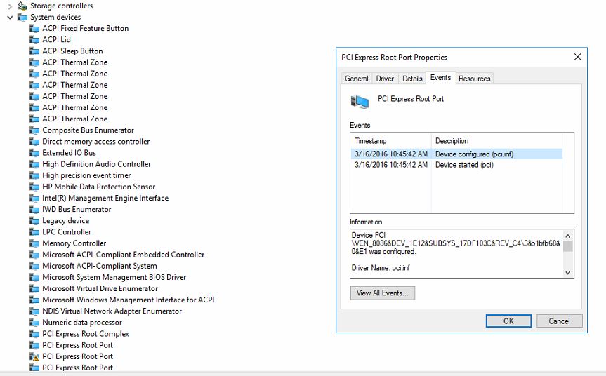

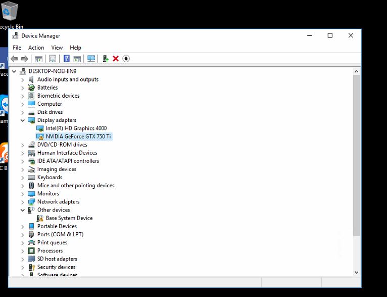

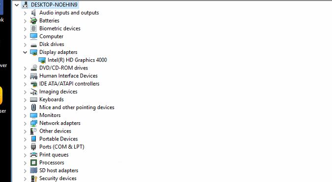

On 3/15/2016 at 0:40 PM, andhie133128 said:
As promised, see below screenshot:
1st. Normal boot up without PCI Compaction, the graphics card showing error 12
2nd. After PCI compaction using 1.30 setup, the graphics card is missing under display adapter
3rd. related to 2nd. checking below, one device showing error 12 which I'm not sure why
Hey, i am having the EXACT same problem with my setup. Trying to run a GTX 750 via expresscard slot on my HP Elitebook 8570w... cant seem to get anything to fix it
Hi, there is some cases that you still need to do the DSDT override + PCI compaction using setup 1.30.
I fixed it and now my setup is working well.
*Windows 10
thanks.

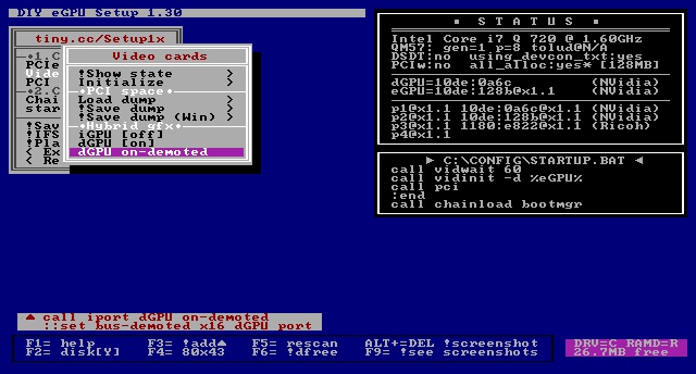

Hi, I detecting the Egpu and evrything is running. But its geting very slow, slower than only CPU.
Running a Asus i7 16gb ram, gtx760m and gtx 590 with cx600wat psu. I can find what type of mPCIe im running but i understand i need to ugrade it to version 1.2? but i relley can not reinstall my windows 10, i just have to much work on it.
I can not figure if i can use USB as boot or not to run the setup1.3?

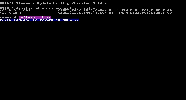

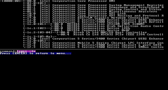

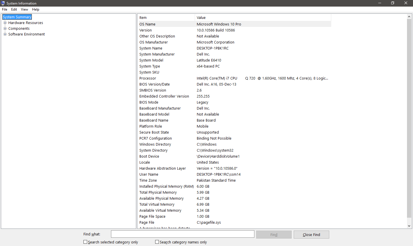

Hello
First of all thanks to @Tech Inferno Fan for helping out regarding my payment issue.
Second of all, I'm confused, my TOLUD is N/A.
First of all my PC specs:
My Laptop is a Dell Latitude E6410
  • Processor: i7-720QM (originally had i7-620M)
  • RAM: 6GB DDR3 1066 (1x4GB , 1x2GB)
  • Chipset: QM57
Now the Setup 1.3 Screen Shots:

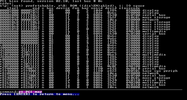

^ This shows tolud@N/A; both the GPUs are detected
^ Both GPUs with their details using nvflash
^ PCI Map
^ PCI Device Tree

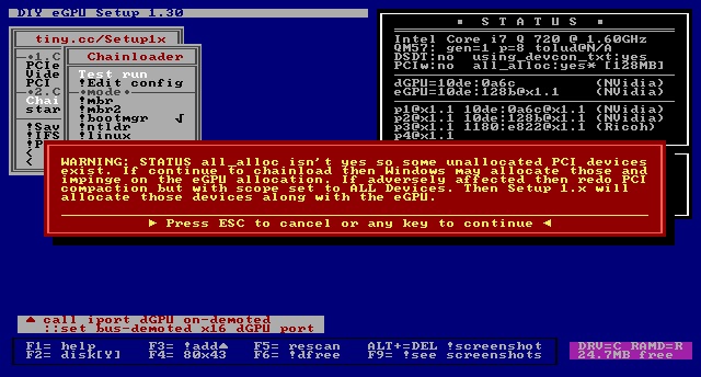

^ Showing error; where as the all_alloc = yes in background
Now for the problem. As soon as Windows starts the card is powered off via PCIe. Now my question. Why is this happening?
So a little help would be awesome.
Regards!
Regards!
Both your dgpu and egpu are allocated ok. With the egpu powering off, check you power leads and psu attached to it.
