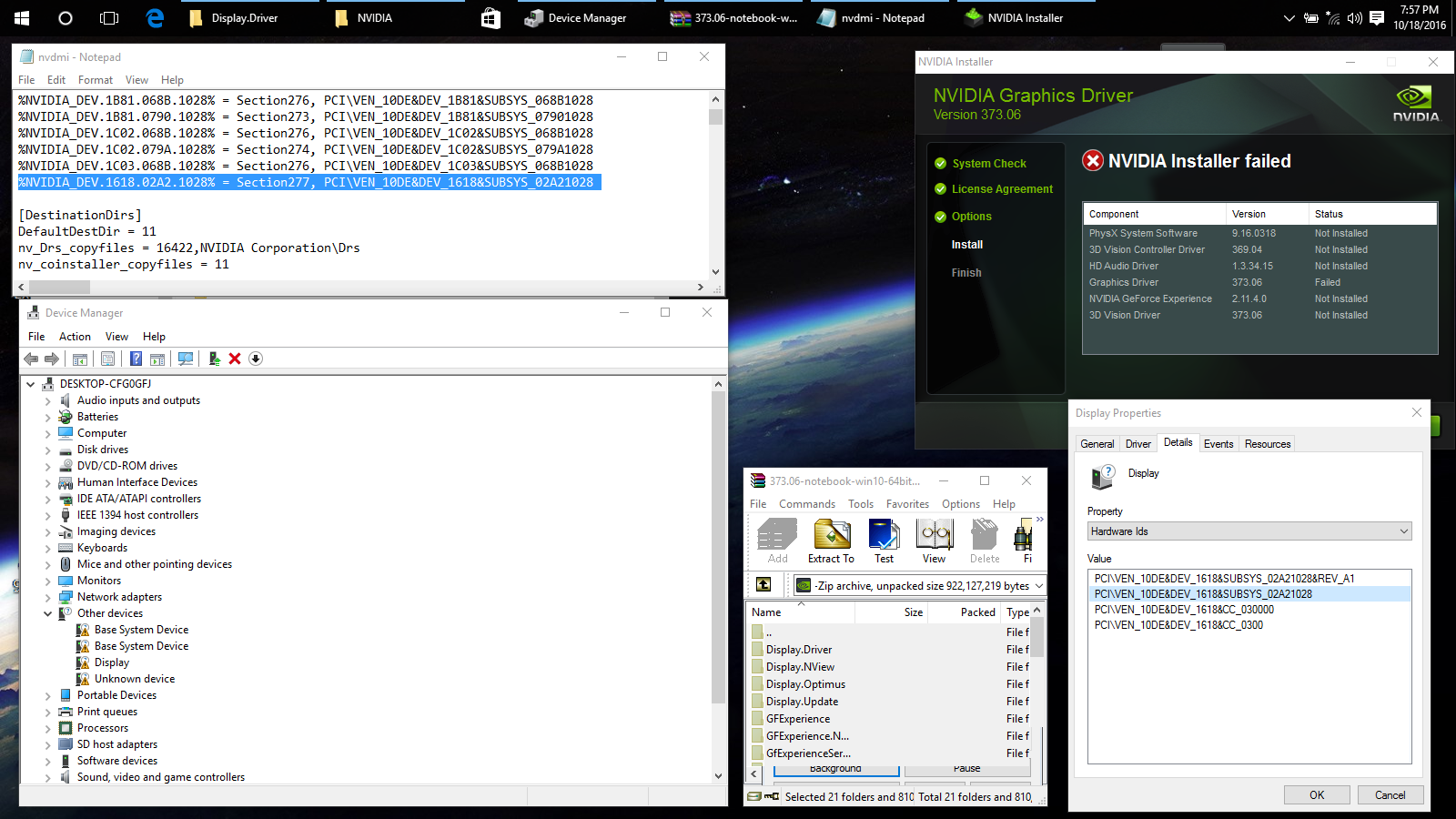

@J95 Thanks for your efforts... This time, after DDU and DSE disabled. The install detects my 970M, starts the installation, slightly flash the screen to black for 1/2 seconds and fails.
Looking at the device managers shows no more 970M device. Looking for hidden devices reveal the device shown as "removed" (code 45). Rebooting leads to the same result.
DDU again and the device shows again.

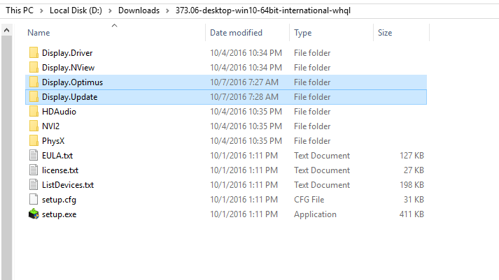

@technos try nv_dispi.inf v373.06 (minor change), remember to delete the folders above. Crashes can occur minutes after quitting firefox anyway.
It is resolved now. Thanks!

So i just bought an alienware m15x off ebay that came with a gtx260m. Its not good enough to play some of the games I own. Looked around for a bit and found that this laptop can have a Clevo Nvidia GTX 970m installed. So I went onto ebay and bought this GTX970m (EBAY listing). I Put the card into the laptop and gave it new paste and then put a fresh copy of Windows 10 Pro X64 on it. The only issue is I cannot have access to the drivers listed on this site. I keep getting linked here and its frustrating me. I want to be able to download the custom drivers to make sure that my card works If I hold onto it to long and find that Its broken, I wont be able to get a refund. How van I go about getting access to the files without having this limit on this account. Im short on time and wont be able to do much after tomorrow. I have work!  Please help me out. I really want to get this beautiful laptop up and running.

I have tried ones found off a video on youtube (HERE) but it does not work, says it cannot find any compatible hardware. And when I tried to make my own custom files, it gets past the first part but fails to install driver part.
Have you disabled DSE?
If not you'll get the same result with drivers from here.

Yes I disabled the windows 10 driver signing enforcement when trying to install.
@SimplexDesigns, I had the same problems with M6700 and a GTX880m - what helped me was modding the INF files from this thread by myself. Basically I had to make the OS and driver think the GTX880m was designed to run in Dell M6700. Adding just one single line didn't give proper results so I decided to find the HWID of my GPU and changed an Alienware HWID part for my M6700 four signs code. However, in order for the driver to work properly I had to change every single chosen Alienware signs for my M6700. It's a bit hard for me to explain typing, so if you need I can mod the INF for you - just write a PM.

  • Display.Driver folder,  copy/overwrite the proper .inf file(s).
  • Extracted driver package >> delete the following folders as shown below (don't skip this step)  -> run setup.exe
