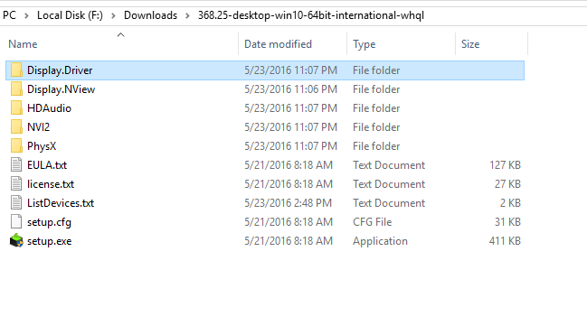

  • Extract driver using 7-Zip
  • Display.Driver folder,  copy/overwrite the proper .inf file
  • Extracted driver package, delete the following folders (as shown below) -> run setup.exe

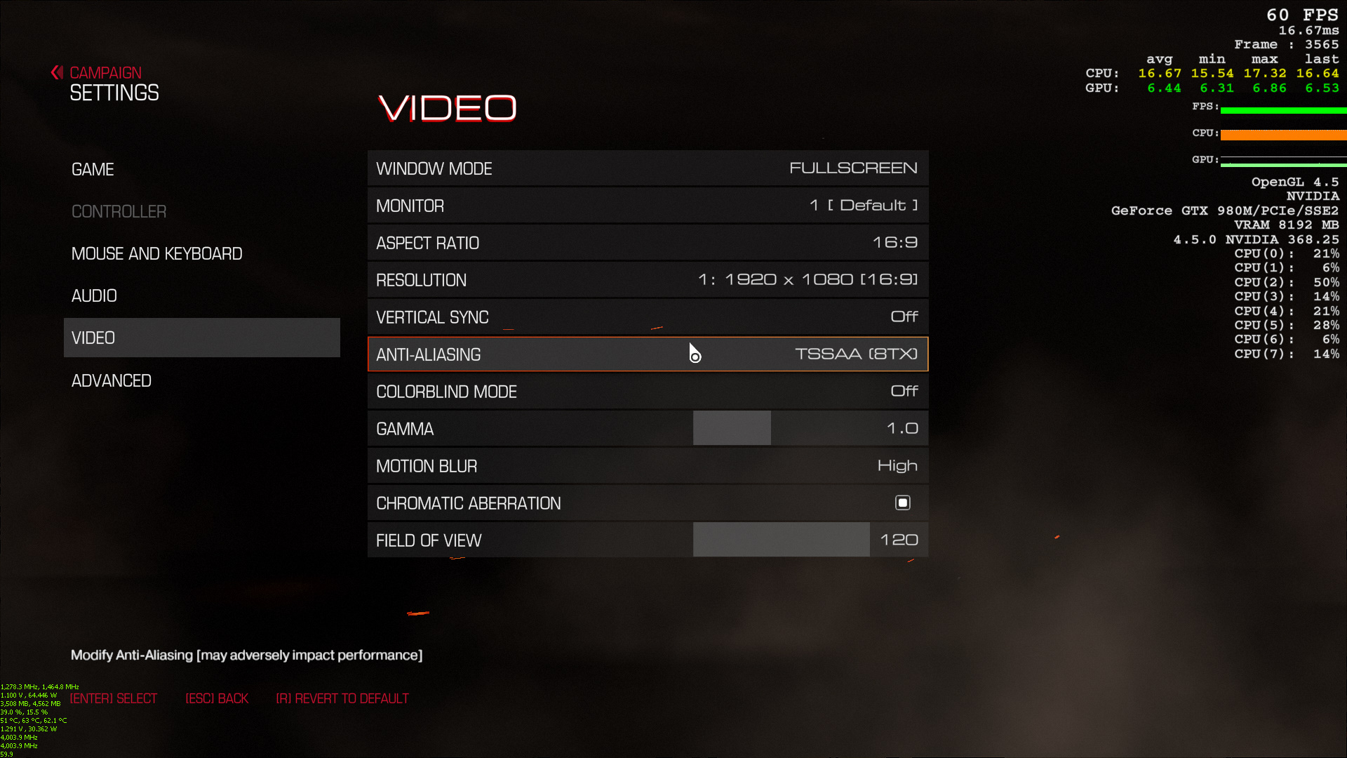

@82280zx  better results?

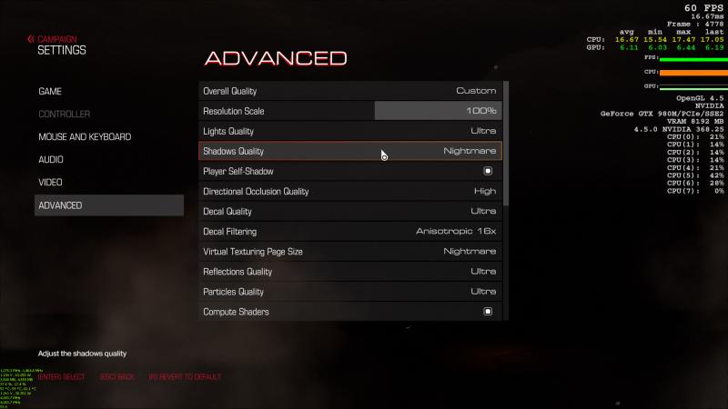

DOOM debug console use the command "menu_advanced_allowallsettings 1"
Shadows Quality: Nightmare
Virtual Texturing Page Size: Nightmare.

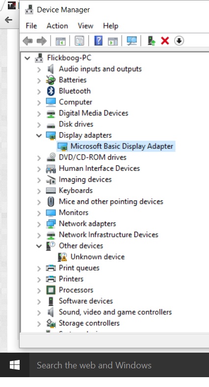

Looking for some help with upgrading a AW m17x R3 system gpu (560m) to a 680m gpu.  Bios is updated to A12, OS is Windows 10.  I've read through this string, but want to make sure I get the right inf file for this upgrade.  The 680m is being delivered in the next few days and want to have everything I need when it arrives.  Any help would be greatly appreciated!!
thanks

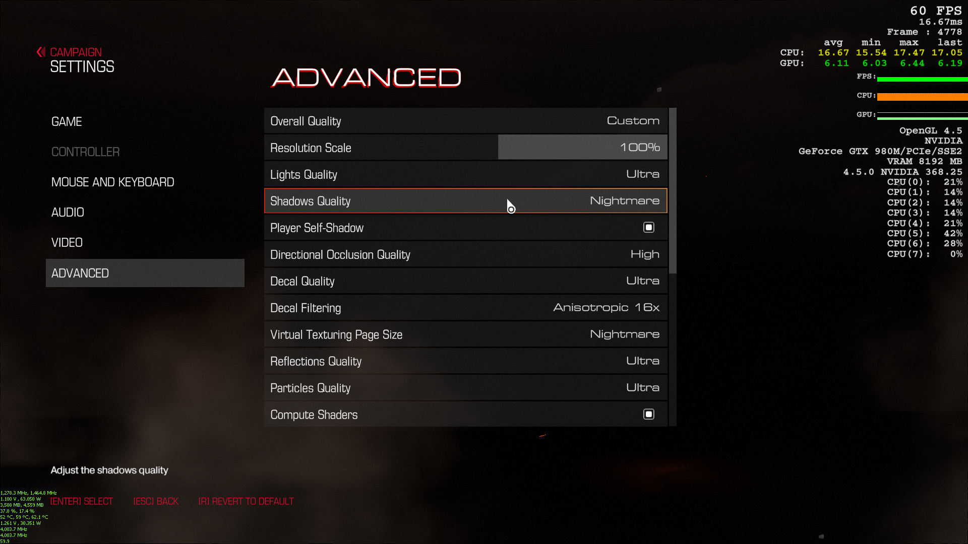

On 5/27/2016 at 2:53 PM, J95 said:
Nope, just nv_dispi.inf.
Running fine w/  @Prema MOD, remember to delete the folders above.

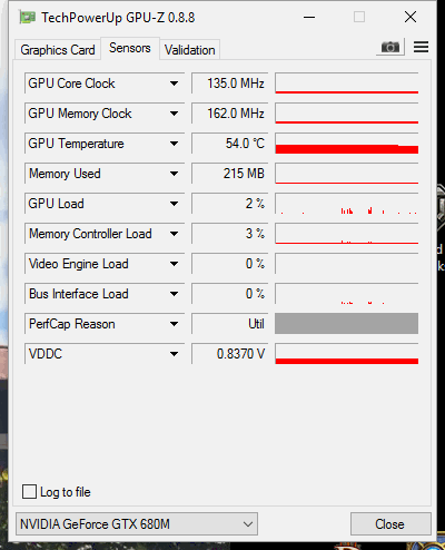

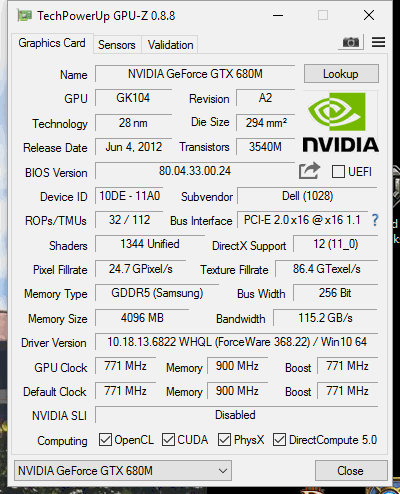

2 hours ago, J95 said:
Device manager, please post HWID (560M). 120Hz model does not require flashing BIOS.
I followed instructions prior to pulling the card, everything worked great with the old 560m card, I pulled it, installed the 680m card, followed instructions again, however the card is not being recognized on my device manager and the installation of nvidia drivers won't continue because it cannot find any compatible hardware.  I have pulled the card reseated it several times and still does not detect the card is installed.  double checked bios and it's A12 version. with IGP disabled and video config set to PEG.  currently using a microsoft basic display adapter... If I can't get it to work today, I will reseat the 560m and send you the HW ID's info.
thanks
Diffuse
Edited by Diffuse

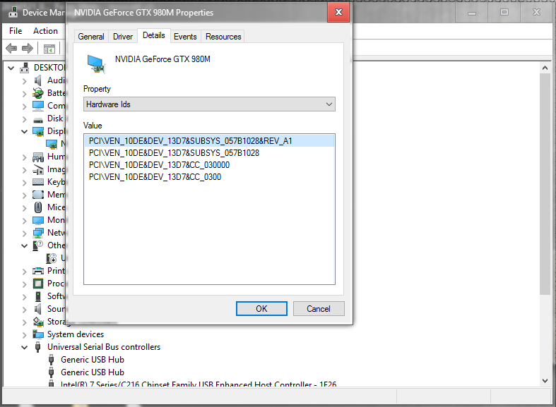

@Diffuse
Just post 680M HWIDs. Microsoft Basic Display Adapter -> Details -> Hardware IDs
Command prompt (Admin)
-> reboot -> keep pressing F8 -> select Safe Mode
  • Run DDU "Clean & Shutdown"
  • Power on -> F8 select "Disable driver signature enforcement"
  • Extract driver package using 7-Zip
  • Display.Driver folder, copy/overwrite nv_dispi.inf  (extracted nv_dispi.inf_v368.22_Win10_PEG_Dedicated.zip)
  • Extracted driver package -> delete the proper folders -> run setup.exe -> Custom install option -> Clean install -> reboot.
Keep these folders only.
361.75.thumb.PNG.cd5111f39779e9d64f24d39
GeForce 368.22 Win10
6 hours ago, J95 said:
@Diffuse
YOU SIR ARE A GIANT walking among mortal men!  thanks!  so far everything running well!  the trick was using the 7-zip utility, once I used that to extract all the files.  no issues.
thanks again!!!
-Diffuse
So everything went good with the installation, but I've been experiencing this slow down, catch up in the video, it seems like it's getting bogged down for something then catches up and runs at good speed. i play shooters and its very noticable when this happens, is this "throttling"?  If so is there anything that can be done, ive lowered the resolutions in game, changed the windowed sizing to help, but it still seems to do this.
Please post a GPU-Z screenshot showing your card's actual specs.
Did you delete the folders above before installing drivers?
Thermal pad placement...including thermal paste?
- I put all new thermal pads on using a thermal pad placement for the 680m website picture (http://forum.notebookreview.com/attachments/680m-thermal-pad-placement-jpg.126047/).  New Arctic silver 5 paste, i even pulled the heatsink last night cleaned it all up, i got a little sloppy yesterday, i was rushing to leave for work.  got a little bit on the card itself, but that should be cleaned up now after cleaning and reapplying the paste last night.  I seem to hit 78c and it will throttle back down to 60c, then back up etc.
- I followed those instructions and I deleted the folders after the driver package from 7-zip installed them all.  (not sure how i can delete them before they are installed???)
- At idle right now the temp is 53C.
Edited by Diffuse
better screenshots - added pad placement link
78C way too high/stock clocks, even for a 560M 75W heat sink (proper heat sink 580M/675M 100W #MT1DN), clearly poor contact between the GPU die and heat sink + components (thermal pads) or heat sink radiator incl fan are clogged with dust...GPU fan working correctly?
1- After extracting driver package delete the following folders:
Display.Optimus
Display.Update
GFExperience
GFExperience.NvStreamSrv
GfExperienceService
LEDVisualizer
MS.NET
MSVCRT
Network.Service
NV3DVision
NV3DVisionUSB.Driver
NvVAD
ShadowPlay
ShieldWirelessController
Update.Core
2-  Display.Driver folder, copy/overwrite nv_dispi.inf  -> run setup.exe
