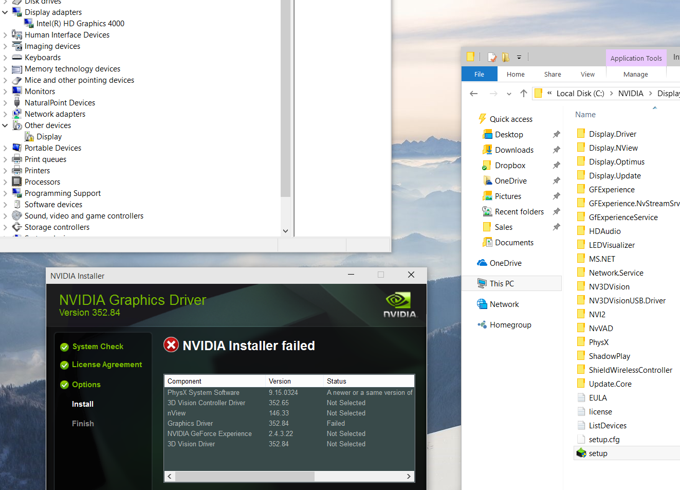

What is DSE ? I also wonder if this driver will install on windows 7 and then show that it is "compatible" for windows 10.. instead of incompatible..so I am off to try it..
What is DSE ? I also wonder if this driver will install on windows 7 and then show that it is "compatible" for windows 10.. instead of incompatible..so I am off to try it..actually says invalid link...for the INF
**Editted**
now link works...
success..
disabled driver signature
But wait... performance is worse then if I was using the HD Intel graphics. Like 3DMark /firestrike give same 1-1.5 FPS
No matter what I do, does not seem to be a way for the computer to use the 980M in windows 10 on the M17X-R4.
It seems to only use the HD intel graphics. Any suggestions would be welcome.
Okay, so I did a re-install. I booted to safe mode, ran command prompt, did the bcdedit, rebooted and selected DSE and then installed the driver. Still doesn't work. It installs, it is seen by HWMOnitor, shows in devicemanager..nvidia control panel is all setup and the right settings used for Optimus as per usual..but when I game or run 3DMark - I get only HD intel graphics working. Ive been trying to get this to work all night. I am using M17X-R4 and a 980M with SLV7's OC'd vBios. What am I missing ? Do I need a unlocked system bios ? Or is this Optimus only working for the AW 17 and not the previous version's M17X-R4 ?
