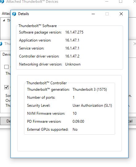

Well I noticed my thread was merged here. I don't see much Thunderbolt 3 discussion in many threads or guides, so I wonder if anyone can help.

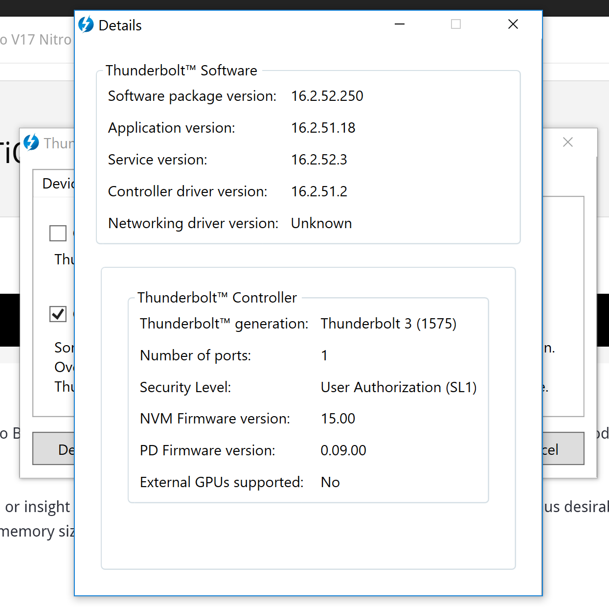

My Acer V17 Black just arrived and AKiTiO's site offers some instructions on how to check for TB3 eGPU compatibility: https://www.akitio.com/information-center/node-gpu-compatibility
Upon following the instructions (after updating all firmware, BIOS, and software I could find) I get the result shown in the attacked pic. I'm unsure what to do next. Does anyone have any experience here?

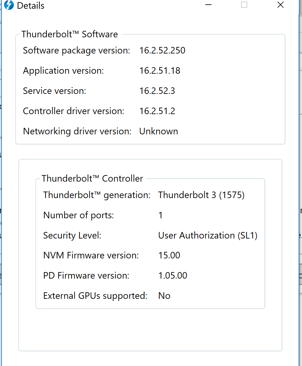

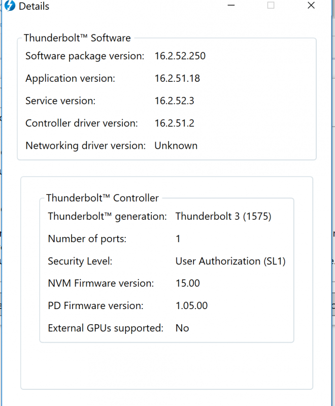

So I hunted around for a more up-to-date Thunderbolt Software package than Acer offers and found this: http://www.station-drivers.com/index.php?option=com_kunena&view=topic&catid=4&id=2249&Itemid=255&lang=en#13633
Being the most recent version I've been able to find, I installed it. After doing so, my result is the attacked picture. At least now the window is showing a few versions numbers. Still, the entire space where the "Thunderbolt Controller" section should be remains blank. I've tried searching for it and NVM and PD Firmware versions (whatever those are) and all I ever find is Thunderbolt Software similar to what I found in the above link.

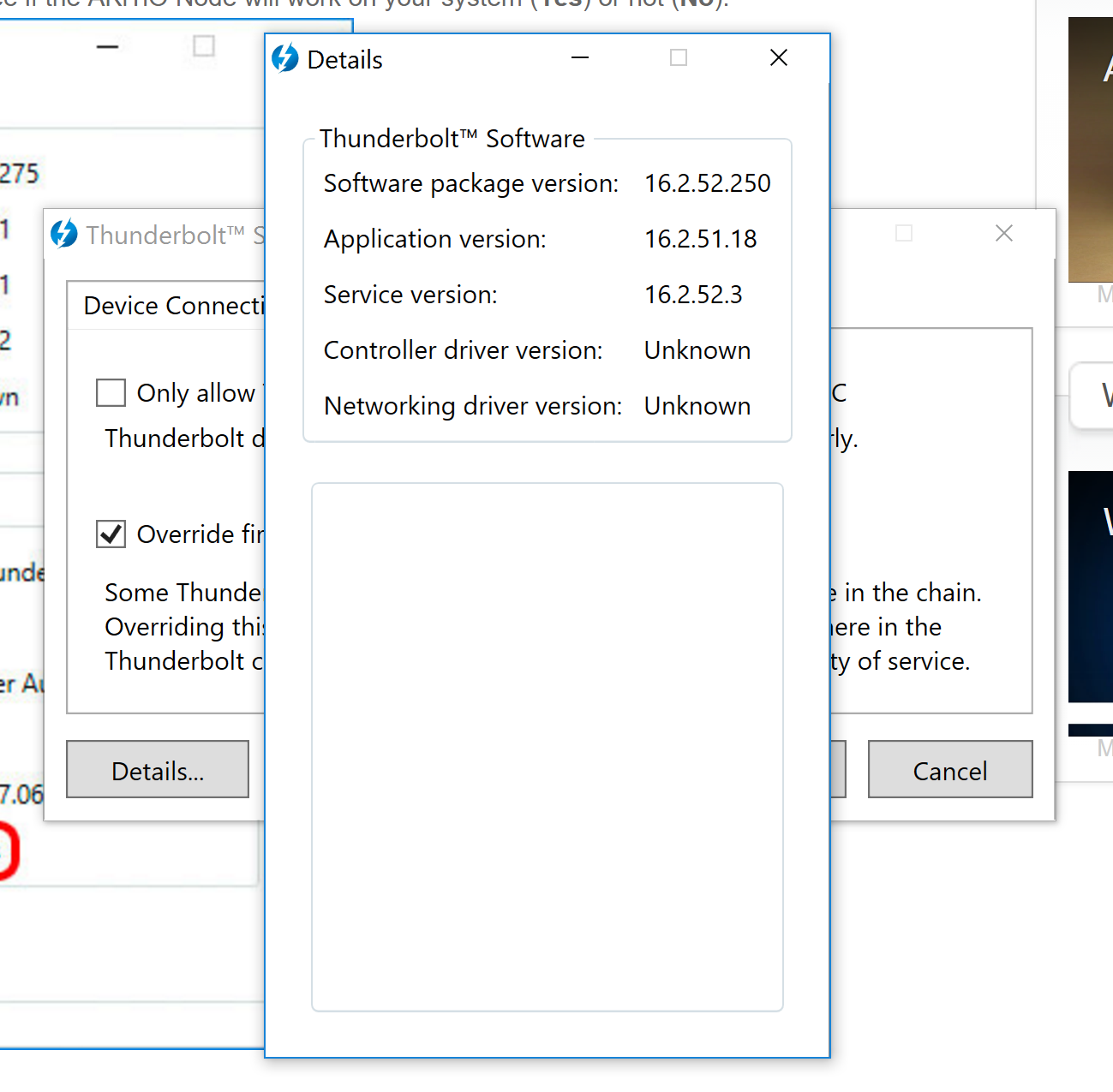

I returned to the Acer page http://www.acer.com/ac/en/US/content/support-product/6404?b=1 and downloaded the "Thunderbolt 3 (NVM: 15) Update Tool.
Note that this is something I had already done when I first received my laptop, and absolutely nothing happened. This time the updater progressed through, and I eventually was given the instructions shown here:

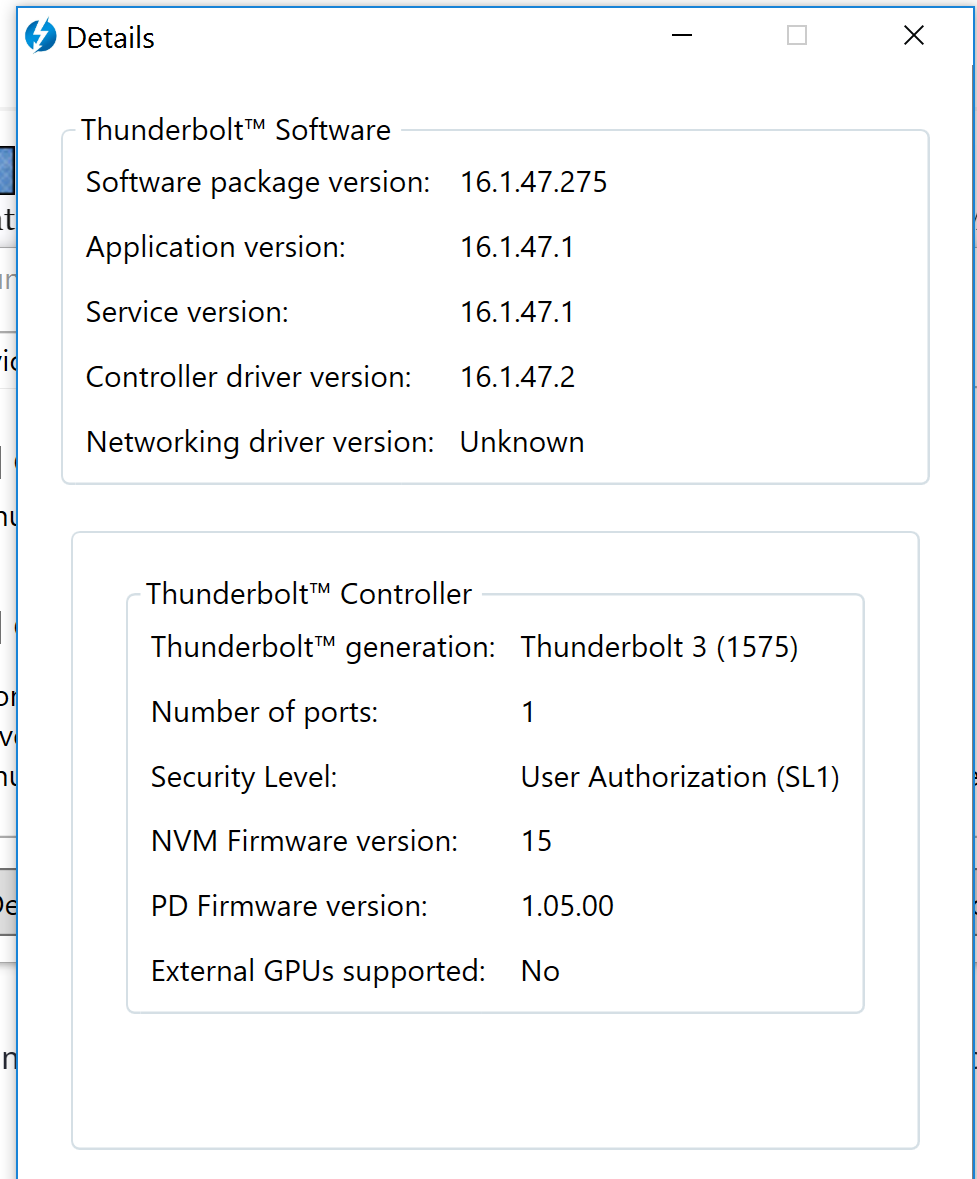

After the restart, the result is what is shown here:
Granted the "No" on the last line is highly disappointing, but so far I think this is forward progress. What I don't know is whether or not this computer will support TB3 given the proper software/firmware or whether this is something that is flat impossible. If it's the latter then I will be very disappointed, as an Acer Technician indicated it would be possible here: http://community.acer.com/t5/V-and-VN-Series-Laptops/V15-Nitro-TB3-eGPU-possible/m-p/412512#M7867

That "No" doesn't mean much.
I have tested this on my P870DM-G, with and without a custom TB3 firmware.

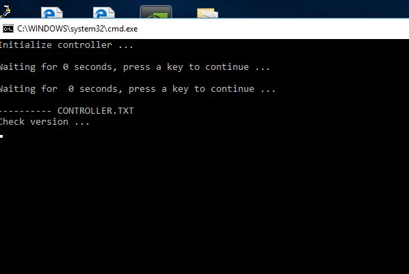

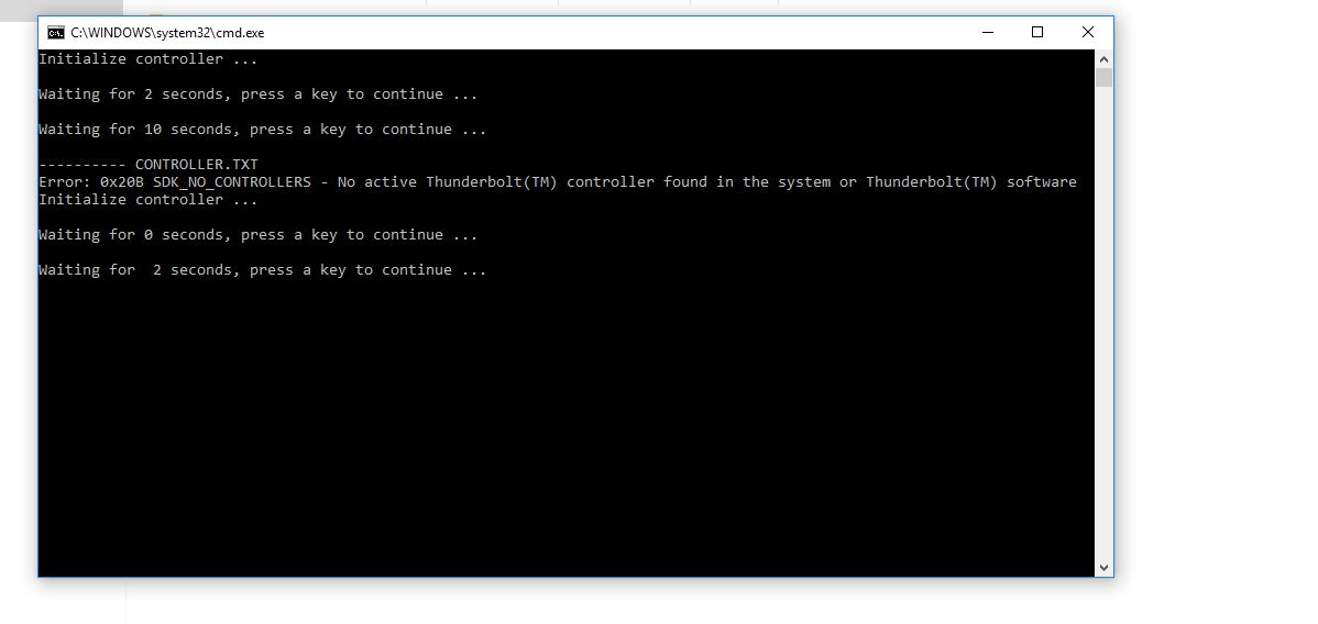

I'm having a hell of a time finding up to date firmware. I've installed and uninstalled so many things at this point my software/firmware now looks like this (notice many of the versions are different) and I've been unable to get it back to the way it was. I'm currently at a loss as to whether this is an improvement or a step backward (note PD firmware is "better" while most everything else is not)...

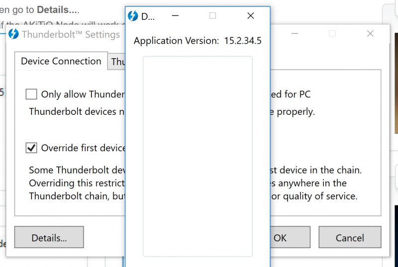

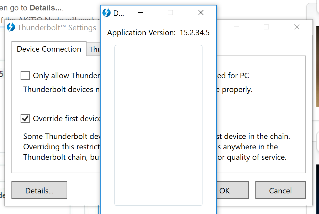

I've managed to get my best results yet by using the Dell Chipset Driver here: http://www.dell.com/support/home/us/en/04/product-support/product/precision-m7710-workstation/drivers/advanced
This resulted in:
This still leaves me at NVM Firmware version 15. I've read that there are versions as high as 30 out there, but I can't seem to locate them. Even if I did, getting them to install might not be possible, as I've found that the installer will check a BIN file vs an expected vendor and error message if they don't match.
With that, I'm really at a loss as to what to do next. I'm hoping for some community help if anyone else knows what I should do next.
Also, does anyone know what the "External GPUs supported" line actually means? Does it mean that "the PC this program is installed on was never tested in-house?" That's an entirely different statement than stating it is flat-out not supported at all. One is a liability CYA statement another is stating a physical impossibility.
