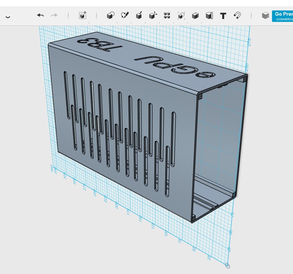

Small update, while I'm waiting for the GPU, I just made my first object in 123D, watched yesterday a tutorial and made today a new case for the Thunder 3, the idea is to print it readjust until it fits, will take me a while as I dont yet a 3D printer, any way, here is the draft.
(it will need several prints till it will be ready since it will shrink and I dont know by how much, not sure how the bracing and perforated writing really will help with thermal issues)
