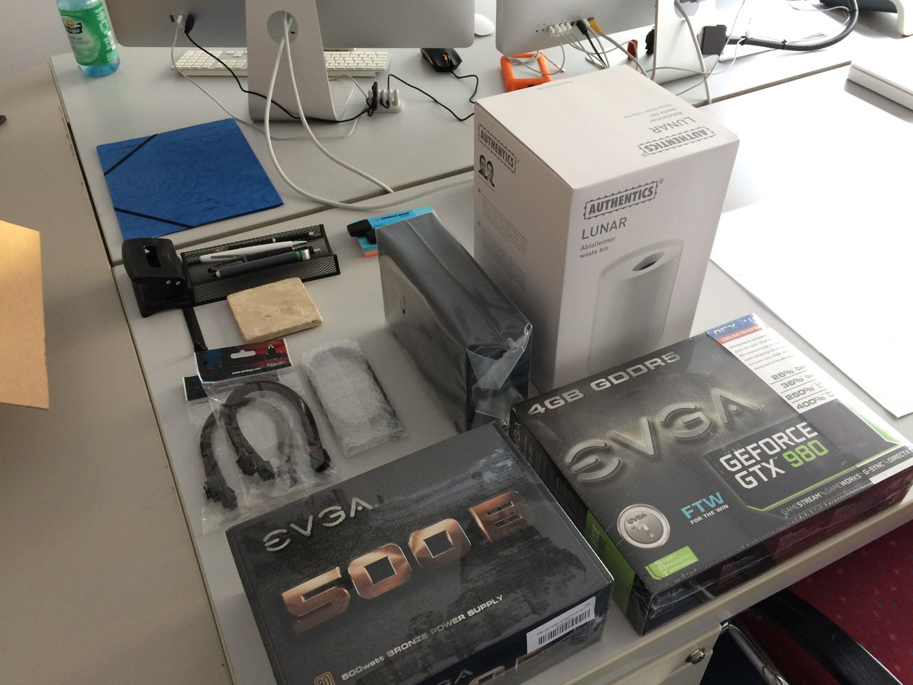

mind Posted November 5, 2015 Share Posted November 5, 2015 Delivery here just in time before Fallout 4. Link to comment Share on other sites More sharing options...
Dschijn Posted November 5, 2015 Share Posted November 5, 2015 So you will open up the ATX PSU to make it fit into the nMP mod? Link to comment Share on other sites More sharing options...
