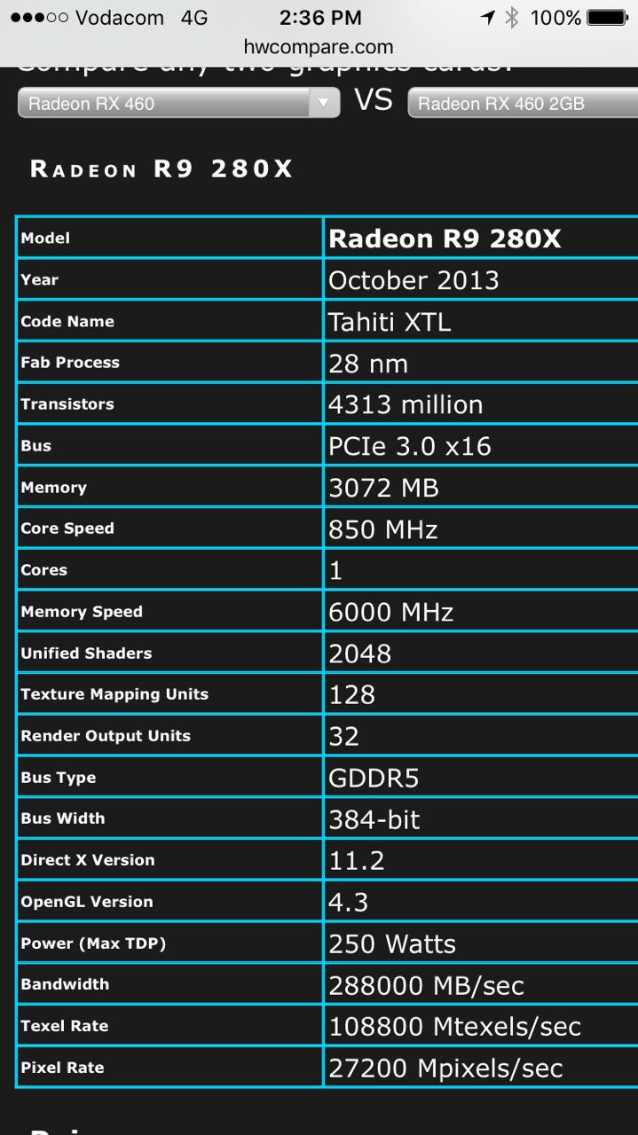

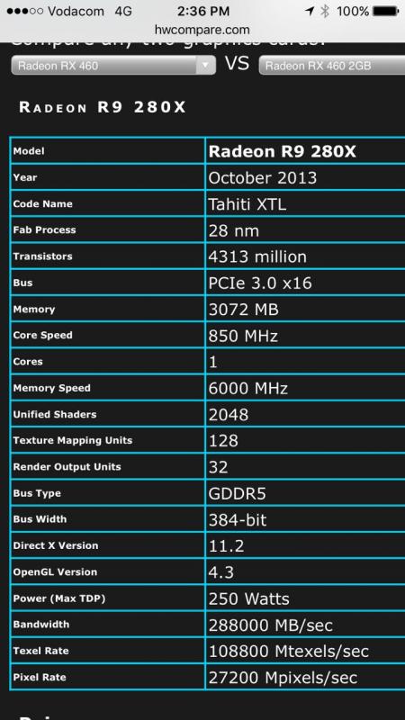

I have an acer 5349 that had a b800 cpu and 2Gb of ram running windows 7 home. Wanting to have a gaming rig and having a limited budget I did some research and started on the road of aperrantly a new addiction of mine.
I diged around and found out I can upgrade my b800 cpu and added a i7 2720qm 2.2ghz with 3.3ghz turbo boost. I also swapped out the one 2gb ram for two 4gb ram. My system max. The temps are running fine with stock cooling and a chill pad. Idle at 45 deg and stress test at 95 deg. Im still going to do some cooling mods.
I have now got my eye on adding an egpu, but with all my reading and searching I was unable to find anything on a egpu setup on my acer aspire 5349.  And aperrantly no one has successfully done so on this model.
So I come here looking for advice and help.
My laptop like most have  mPcie witch I was hoping to use for the connection between the gpu and my laptop.
I am about to place an order for the PE4C v3.0 to use as ny interface box. But before I do so would like to know if it is the right one and secondly if it is the best option to get the max performance from the connection.
I have available a 550w gigabyte power supply im going to use and for the graphics card a Radion R9 280X. Would that be fine ?
I'm hoping to do a step by step update as I build my setup and also get help with trouble shooting is I continue as I'm sure there will be.
In advance thanx for the help in advance. Please let me know if we need more information.
Attached is the graphics card specs.
