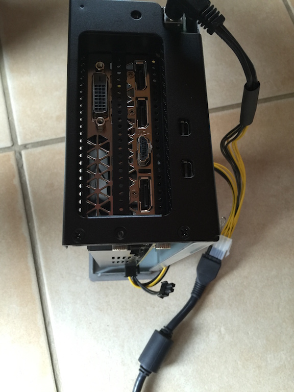

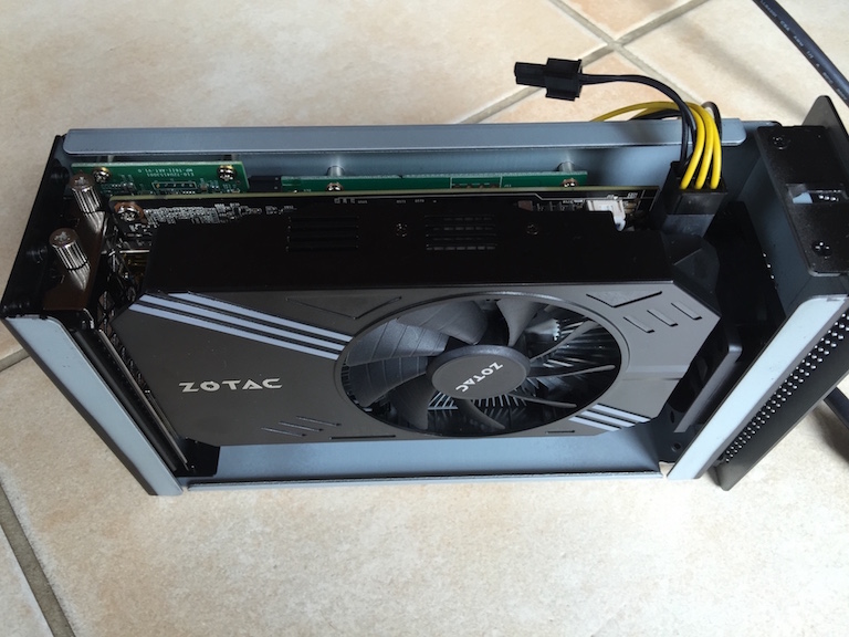

I took some pictures for you to see. I will have to load them to the Mac to be able to shrink them first.

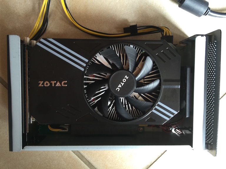

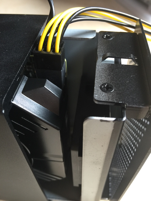

The card itself fits really nicely, but the power plug is a bit too high. Maybe I can modify it. Until then, I will leave the box open.

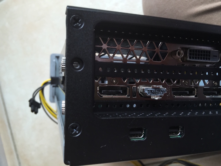

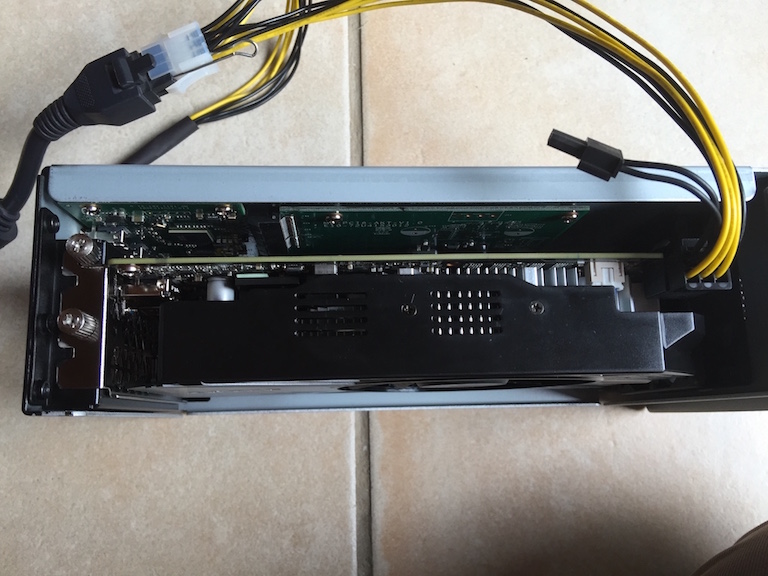

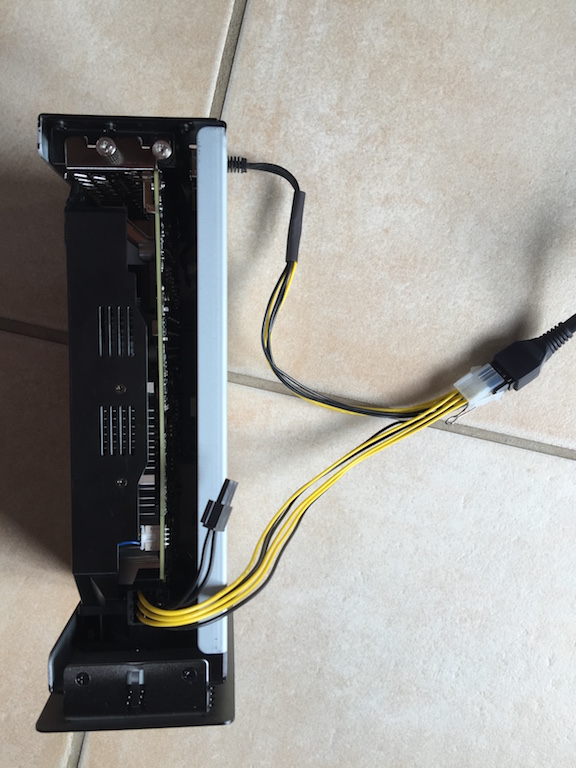

These images show, how well the Zotac Geforce GTX 1060 Mini fits into the Akitio Thunder2. Note the 6-PIN PCIe power connector blocking the way for the outer chassis.
I just noticed, my HDMI cable broke. On the last pic you can see the broken plug still firmly in the socket... :sour:

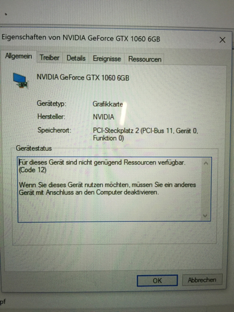

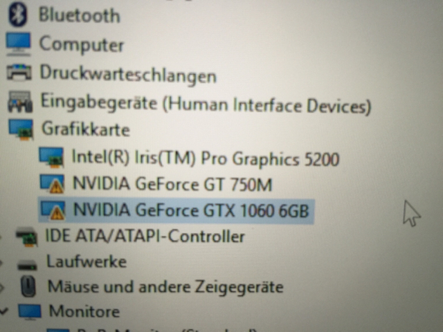

After installing rEfind and using it to reveal the Intel Iris, Windows suddenly booted through and showed all 3 graphics adapters for the First time!
Look at this!

It really seems like you have to somehow disable the 750M to create enough "free recources" for the eGPU.
Yes, it already WAS disabled, by the time Windows stopped working altogether. In the last 2 days I disabled it countless times. It must be sore from disabling!

I can not reproduce the screen shots from above, anymore. During the last week, I booted about a hundred times, and I got the 1060 to show up in the device manager only ONCE! Since so many people can get it running, there MUST be a way! How can I convince my Windows 10 (EFI) to boot with my eGPU connected? Any help appreciated.
Finally! It appeared! Hallelujah! I saw the Windows Login-Screen on my external display, which is connected to the 1060 via HDMI!
I had booted without revealing the Intel Iris and with the 750m deinstalled.
But then Windows decided, this would be enough joy and hope and disabled the 1060 in favor of the 750m. Yes. That's right. This f**** system decides, the user (me) is obviously stupid and it knows better. 3 seconds. A short glamorous moment.
Then the login screen switched to the internal display and the device manager showed error 12 for the 1060.
