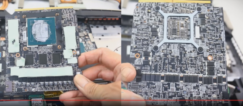

Guest Posted August 22, 2016 Share Posted August 22, 2016 Also leaving this MSI 1080 (single) here until we get clean shots: THX @J95 Quote Link to comment Share on other sites More sharing options...
knight Posted August 22, 2016 Share Posted August 22, 2016 Almost can not see the PCB on reverse... I remember times when GPU PCB's we're almost empty. Quote Link to comment Share on other sites More sharing options...
Guest Posted August 22, 2016 Share Posted August 22, 2016 13 minutes ago, knight said: Almost can not see the PCB on reverse... I remember times when GPU PCB's we're almost empty. If you compare the MSI to the Clevo 1080 PCB there is a night and day difference. Clevo seems to have cut many corners compared to MSI if the population of components on the PCB is any degree of indicator of quality. They don't even look like similar products. Quote Link to comment Share on other sites More sharing options...
ajc9988 Posted August 22, 2016 Share Posted August 22, 2016 If you compare the MSI to the Clevo 1080 PCB there is a night and day difference. Clevo seems to have cut many corners compared to MSI if the population of components on the PCB is any degree of indicator of quality. They don't even look like similar products.Looks can be deceiving, but also without having a reference design anymore, msi may have an advantage in designing cards because of experience with aftermarket desktop oc cards. Then again, if it runs so hot already, why build it out for overclocking ability when you know it is heat limited no matter what you do? Just playing devil's advocate...Sent from my SM-G900P using Tapatalk Quote Link to comment Share on other sites More sharing options...
Guest Posted August 22, 2016 Share Posted August 22, 2016 OK, added 'clean' MSI GTX 1080 (single) shots to the OP! @Khenglish What does our 'GPU DOC' have to say about Clevo and MSI 1080 designs? Quote Link to comment Share on other sites More sharing options...

Guest Posted August 22, 2016 Share Posted August 22, 2016 17 minutes ago, Prema said: OK, added 'clean' MSI GTX 1080 (single) shots to the OP! @Khenglish What does our 'GPU DOC' have to say about Clevo and MSI 1080designs? Very convenient that they omitted the SLI bridge connector. That was mighty white of them. Tell me that was an accident, LOL. Other than that one nasty flaw, it certainly looks like a more robust GPU than what Clevo hath wrought. Quote Link to comment Share on other sites More sharing options...
Guest Posted August 22, 2016 Share Posted August 22, 2016 5 minutes ago, johnksss said: And yes friends! We have yet another new power connector. Good catch. These folks definitely are not working together for the good of end users. The more I see the less I want to continue to be part of the high performance notebook scene. It's turning into a real joke, even more so than it was last year. And, that was bad enough. Doing hardware mods is cool when you want to. Having to do hardware mods for everything just to achieve basic functionality is no way to live. Quote Link to comment Share on other sites More sharing options...
Guest Posted August 22, 2016 Share Posted August 22, 2016 2 hours ago, johnksss said: And yes friends! We have yet another new power connector. MSI used the same 6(+1) PIN design on their GT72S 980. 2 hours ago, Mr. Fox said: Very convenient that they omitted the SLI bridge connector. That was might white of them. That and two things that can't be seen easily unless put them next to each other: - MSI card is shorter than the Clevo card (ends at the level where Clevo has it's connector) - Core positions don't line up. MSI core is a lot closer to the MXM slot So there you go, don't think you can just interchange them... It's all VERY strange as all MXM cards are made in the same 'MSI-run' factory...why would they not agree on a new standard and just leave NVIDIA out of the equation? Quote Link to comment Share on other sites More sharing options...
Guest Posted August 22, 2016 Share Posted August 22, 2016 1 hour ago, Prema said: MSI used the same 6(+1) PIN design on their GT72S 980. That and two things that can't be seen easily unless put them next to each other: - MSI card is shorter than the Clevo card (ends at the level where Clevo has it's connector) - Core positions don't line up. MSI core is a lot closer to the MXM slot So there you go, don't think you can just interchange them... It's all VERY strange as all MXM cards are made in the same 'MSI-run' factory...why would they not agree on a new standard and just leave NVIDIA out of the equation? Yes, I was talking with @J95 about that offline a day or two back, before the previous MSI photos were posted. That was the first thing that jumped out at me. The core is in a totally different spot, closer to the MXM edge connector and shifted to the side as well. Each new discovery drives another nail into the coffin. This is starting to look as though the situation is far more adverse than only the P870DM-G not being upgradable. This looks as if it rises to the level of collusion and an intentional effort to block notebook upgrading of any kind, defrauding all customers everywhere, regardless of their brand preference. Not a good time to be a notebook enthusiast any more. If these bastards are allowed to get away with this, everyone will probably find their sorry asses in the same sinking boat with new GPUs next year. Time to say no to notebooks. Quote Link to comment Share on other sites More sharing options...

bloodhawk Posted August 22, 2016 Share Posted August 22, 2016 Dang the MSI single 1080 has 9 Power phases. Versus the 4+2 or 6 +2 on the Clevo's ? Either ways the MSI ones seem to be way more robust. Quote Link to comment Share on other sites More sharing options...
Khenglish Posted August 22, 2016 Share Posted August 22, 2016 (edited) 1 hour ago, Prema said: OK, added 'clean' MSI GTX 1080 (single) shots to the OP! @Khenglish What does our 'GPU DOC' have to say about Clevo and MSI 1080 designs? Honestly both are overkill and majorly beat out the 1080 Founder's edition. The voltage regulation on either card is good enough for LN2 overclocking, The Clevo is rated for 480A on the core and the MSI is rated for 640A. The Desktop FE can only do 250A, and that's questionable as it relies on its FET's pulse current specification. It looks like the MSI only has one memory phase while the Clevo has 2, but the MSI has more core phases. I'm not sure of the core phase configuration on the MSI, but it looks like an unheard of triple VRM design, with 4+2+2 phases on the core vs the 4+2 on the Clevo. Honestly I would consider any thing more than 4 phases to be unnecessary, and both greatly exceed 4 phases. The Clevo will likely be a little more power efficient as the lower 2 core phases pull juice from the very close by MXM power connector which can supply a very high amount of juice, while the MSI will pull relatively more current from the power cable. An unknown at this point is the PCB thickness. There are 2 thickness options to still fit in an MXM slot, and most cards were the thinner option. If one card is thicker than the other, that would outweigh any other difference between them. You'll get much higher power efficiency and likely memory clocks too. I was hoping MSI would match the 1070 form factor. It looks like the MSI 1070 is the only Pascal card that can be fit into an existing MXM system without ridiculous mods. The mods may still be rather extreme (it looks like I would need to remove the subwoofer and slide the SATA slot slightly forward on the P150EM motherboard), but at least the core placement is the same as standard MXM 3 cards and the GPU fan is not in the way. Edited August 22, 2016 by Khenglish 8 Quote Link to comment Share on other sites More sharing options...

ajc9988 Posted August 22, 2016 Share Posted August 22, 2016 Honestly both are overkill and majorly beat out the 1080 Founder's edition. The voltage regulation on either card is good enough for LN2 overclocking, The Clevo is rated for 480A on the core and the MSI is rated for 640A. The Desktop FE can only do 250A, and that's questionable as it relies on its FET's pulse current specification. It looks like the MSI only has one memory phase while the Clevo has 2, but the MSI has more core phases. I'm not sure of the core phase configuration on the MSI, but it looks like an unheard of triple VRM design, with 4+2+2 phases on the core vs the 4+2 on the Clevo. Honestly I would consider any thing more than 4 phases to be unnecessary, and both greatly exceed 4 phases. The Clevo will likely be a little more power efficient as the lower 2 core phases pull juice from the very close by MXM power connector which can supply a very high amount of juice, while the MSI will pull relatively more current from the power cable. An unknown at this point is the PCB thickness. There are 2 thickness options to still fit in an MXM slot, and most cards were the thinner option. If one card is thicker than the other, that would outweigh any other difference between them. You'll get much higher power efficiency and likely memory clocks too. I was hoping MSI would match the 1070 form factor. It looks like the MSI 1070 is the only Pascal card that can be fit into an existing MXM system without ridiculous mods. The mods may still be rather extreme (it looks like I would need to remove the subwoofer and slide the SATA slot slightly forward on the P150EM motherboard), but at least the core placement is the same as standard MXM 3 cards and the GPU fan is not in the way.So who's going to get the mxm to pcie adaptor and bust out their ln2 pot for that msi card?Sent from my SM-G900P using Tapatalk Quote Link to comment Share on other sites More sharing options...

Guest Posted August 23, 2016 Share Posted August 23, 2016 Added 'clean' shots of CLEVO 1060 to the OP! @Khenglish MSI and CLEVO 1080 MP boards share identical thickness. Quote Link to comment Share on other sites More sharing options...
