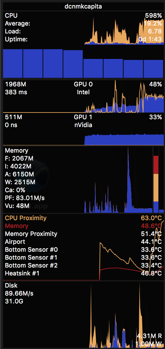

I'm having the same issue. All works fine, but in Final Cut or Premiere still de CPU and internal graphics is doing all the work, while the eGPU ist chilling...
