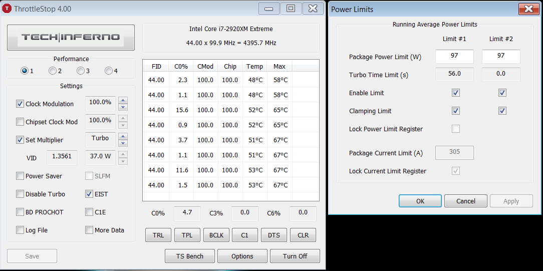

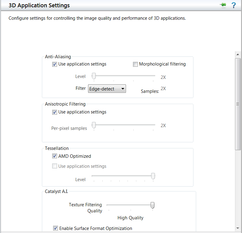

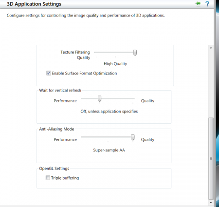

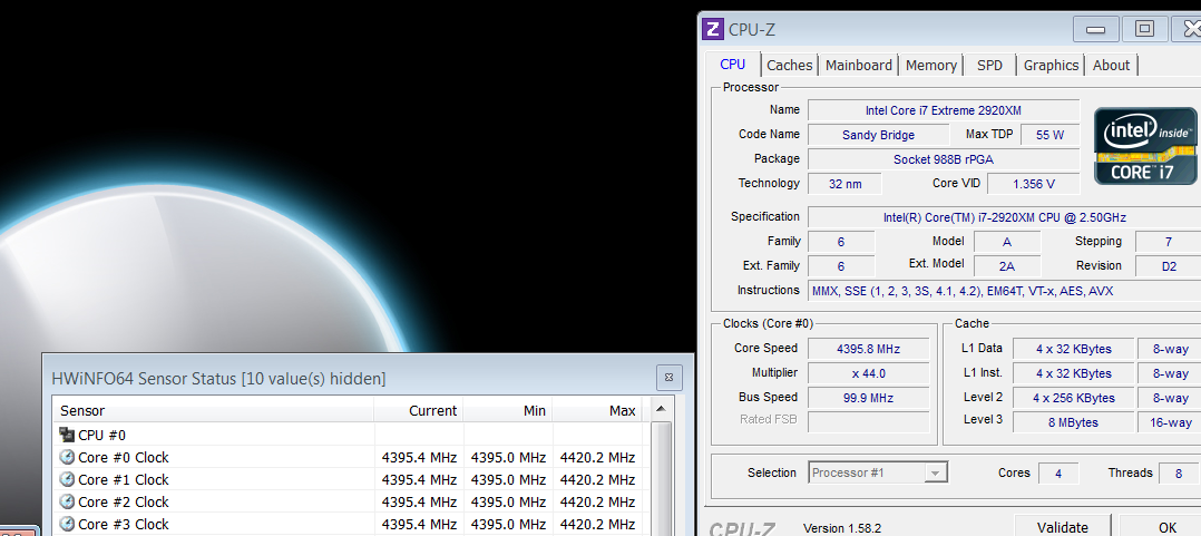

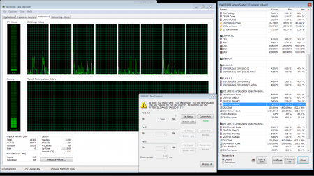

85c max for days of 3d gaming i left my m18x on as long as you see in this pic... on desktop no longer than 5 minutes that whole time except the time needed to install skyrim. this is 45%time was in game in dirt3 ultra 8xaa with edge detect and SSAA set in CC... 45% time in BF3 all of these in 1080P and same CC settings BF3 was ultra settings so 4xAA and then Skyrim which was set to ultra every slider up and everything checked with even FXAA and AF @16 and 8xaa well it got seemingly 5-20fps depending and i exited and set no AA but all the rest same and seemed very smooth only dropping performance in heavy loaded areas. i'll have to get a few comparison pics up for you guys and use Fraps... with different threading... and turbo... but here is example temps are good. fans on max with hwinfo on auto profile...
2920xm @stock volts 310amp, 97watts, 44x99.9,core states off, never drops 4.4ghz unless IBT,prime95 type load... wprime stays 4.4. not benching temps room temps 70-80F... usually 80 since the M18x seems to heat my office lol wouldnt think it possible... 6970m X2 @822 1100mhz on all power profiles so never drops to save power... hence the min/max is same mhz... this thing was pushing it self for so many hours and had those temps with al those games one after another i would play whenever i could... and leave in game sitting there no pausing... those are temps that one should be safe to say no worries. 95~ is a safe max on cpu though if its only a max in worst case scenario (fully loaded) but much better if temps nver reach that in real world use.
this is how i had TS set.... but is a pic from now so ignore those temp they are low since this is a pic just of how i leave TS set
