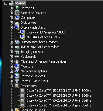

15 hours ago, fandangos said:
Sicne my notebook uses an i7 second generation I don't have a intel graphics here.
Yes you do.
Only Nvidia notebook drivers have Optimus included, which is required for internal LCD operation.
Install them.
If you really don't have HDG3k, which should not be the case, then
